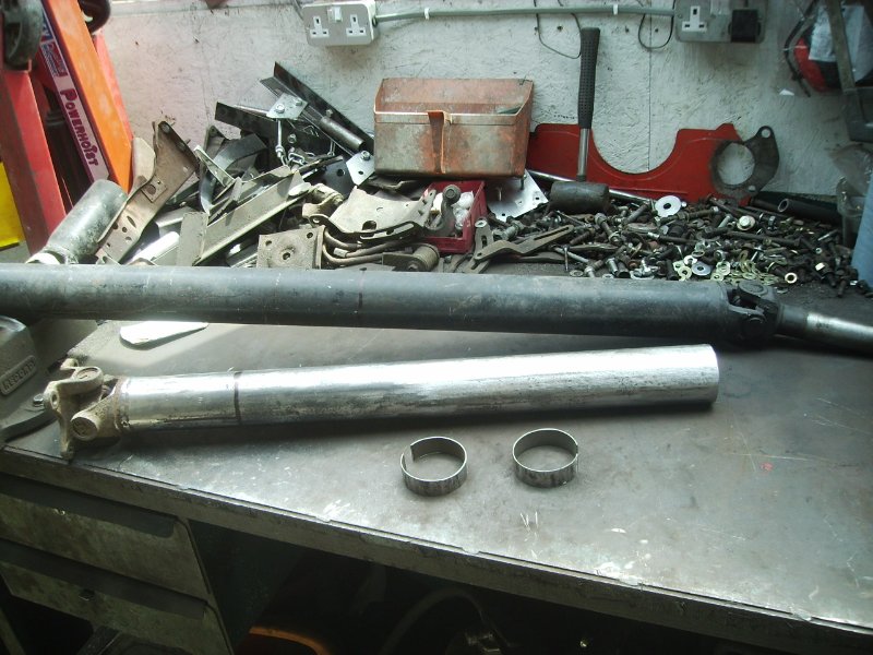

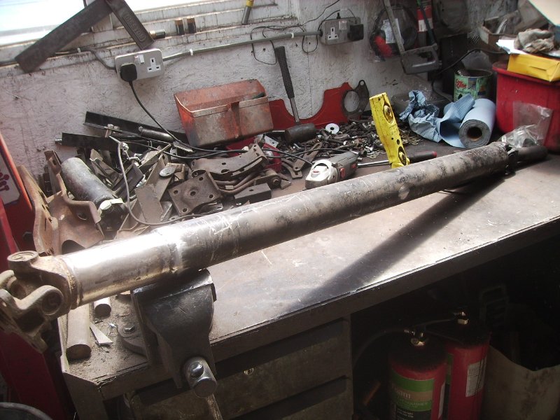

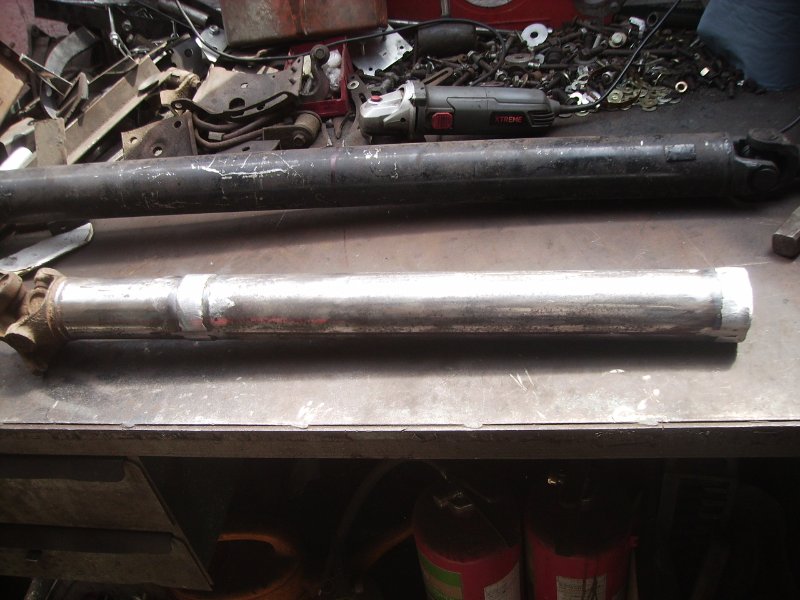

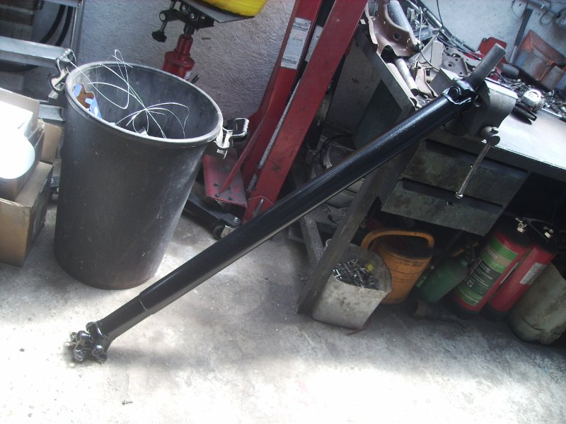

i started on the hybrid propshaft today. the explorer tube is smaller than the mopar tube so will slide inside. it's not a good fit but it is the correct difference to allow a couple of sleeves made from one of the tubes to fit and weld tight on the small tube which is then a very tight fit inside the large tube which will be welded also. it'll sleeve about 2' 6" inside so nice and straight, if it needs balancing at all i'll sort that later. i'll sort some pics tomorrow as i get it done. i've done many prop's this way so don't have any issues with it.

i finished up the propshaft today, it all went as expected and i gave it a couple of coats of primer and some satin black so it's now ready to fit when the time comes.

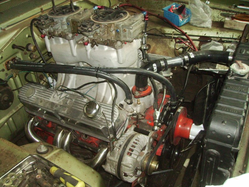

today i painted the new water pump (it's cast iron so would rust real fast) and while it was drying i finalised the spacers needed for the alternator brackets. then i bolted on the mechanical fuel pump, of course the fuel hose from the hard line was roughly 2" short so that'll need replacing. i'll get ethanol resistant hose and replace the bit at the tank end too. after lunch i fitted the new water pump and alternator with it's brackets for the last time. just the fan spacer and fan and i can sort the rad' hoses. oh and a couple of heater hose fittings for the water pump and intake, i like to use my cars in the winter too and the heater worked great when i used it last. i sorted through the fan belts i have here and none are long enough, the closest being about 3/4" too short so i'll order that next week too.

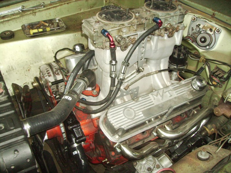

i started fitting stuff today. all of the new fuel pipes and filters are in place, i'm just waiting for hose clamps to finish that off. i've fitted stainless p clips just under the 2 filters and y piece to stop them waving about and breaking the glass tubes. i also fitted the flexalite 2" fan spacer kit which has placed the flex fan about an inch back from the radiator core. i ordered a fanbelt and collected the silicon hoses, ally tubes and stainless clamps this evening too for the radiator hoses. last job was to check the wiring for the ignition sub loom as i'm fitting mopar electronic ignition where this car was points before.

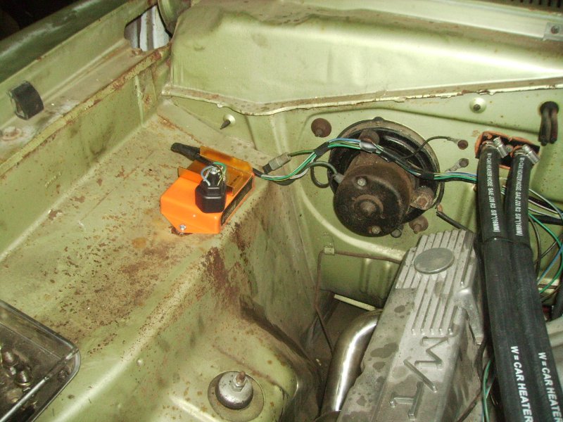

today i did the radiator hoses, heater hoses and fittings, temp' sender, fanbelt and fitted the ignition box to the inner wing. still waiting for the hose clamps for the fuel lines. the engine compartment is starting to look much 'busier' now. oh, and i ordered 2 air filters so i can cut the bonnet and see if the scoop clears or will need altering/raising up a bit. i'll be sorting the engine bay wiring next, it's getting close to a fire up
