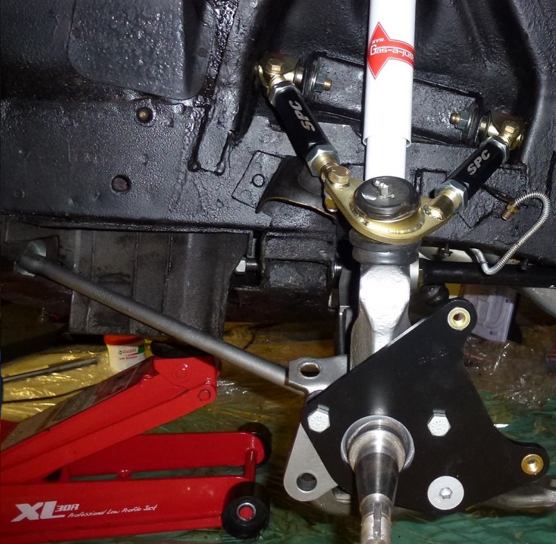

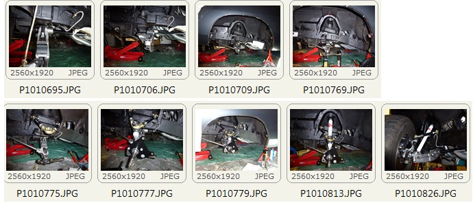

I should have pictures - i tend to take them at every stage when i am doing something. I will have a look when i get in front of a pc.
Posts: 4262
These are the best I have that show assembly pre-brakes.
If these are any good, tell me which and I'll post them.
If they are not, circle the bit you are interested in and I'll see what I have. :thumbright:

Looks like the 8th pic, the one ending in the numbers 813 is the clearest one. I'm now thinking that even though I haven't disturbed the UCA at all, that might be the problem.
I only needed to change the bushes in the LCA so left the UCA in place thinking it would be ok. Because I've removed everything else though, as I'm putting it back together, the strut rod seems to be too long and preventing the ball joint end of the LCA from sitting far enough forward, giving me negative castor.

813... Note these pictures are 'pre-setup' (i.e. I had not had my alignment done. They are in the ballpark, but not perfect).
