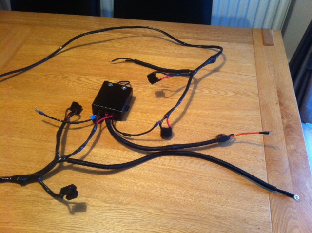

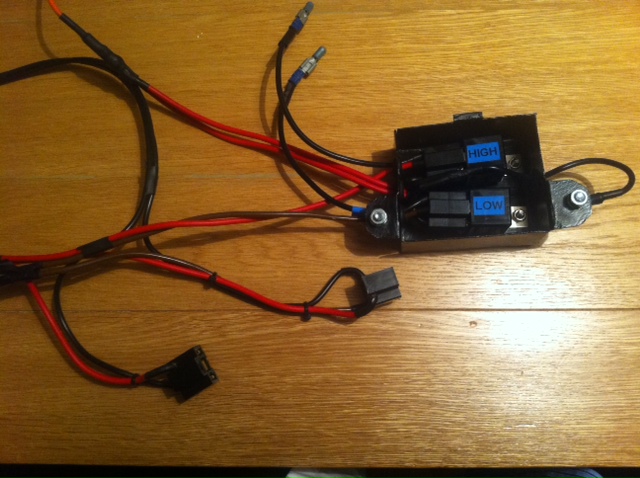

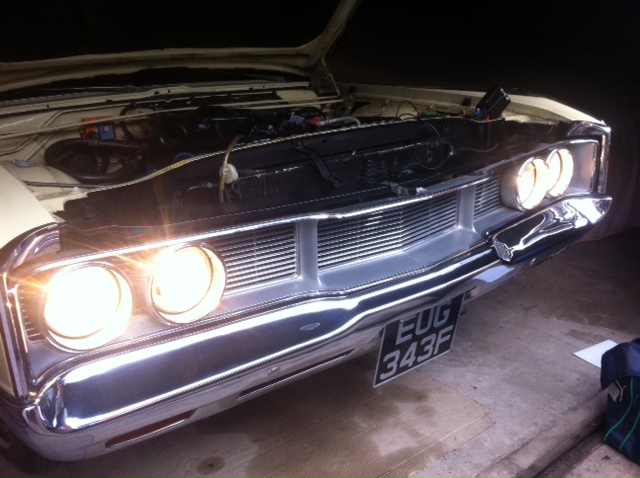

Job done!....had a good result with this today.... Did a test fit on the loom today, everything works ok thankfully, steady 12.3V at each lamp. Everything switches fine so am pleased with the results!
Cant do a permanent fit yet as I need to drill a few holes etc and cant do that at the garage I rent. Ive taped the loom up now and its ready to go in next time car is at home (Thursday hopefully).
Thanks for all your help with this gents,
Cheers Steve :thumbright:
loom taped up.jpg (132.84 KiB) Viewed 1065 times
rear of relay box.jpg (125.52 KiB) Viewed 1065 times

Was that voltage with the engine switched off?
You should have around 14.5 volts with the engine running. ;)
Posts: 7613
Switched off Dave....just wanted to make sure it works before I start the car up and bring her home to do final fit.....was very cold so couldnt be bothered to un clamp her etc. Going back over Thursday to collect her (weather permitting) so will do a full test then :thumbright:

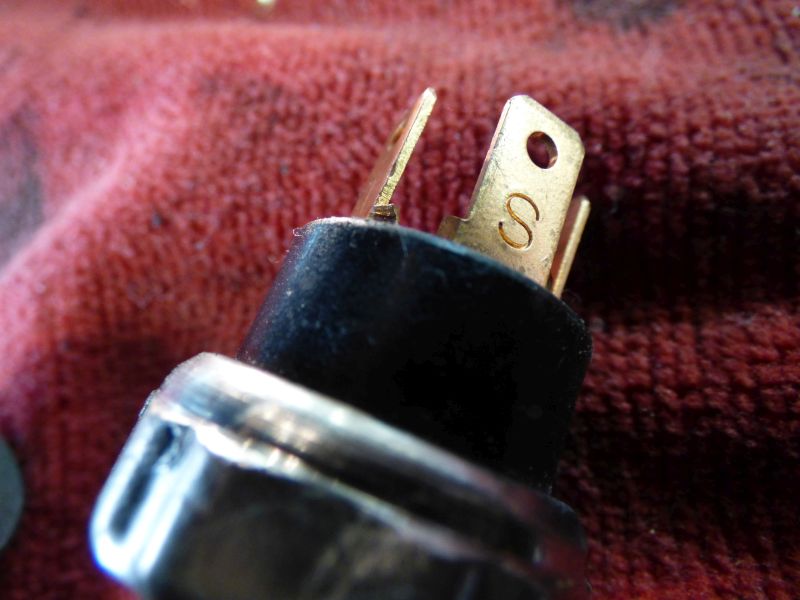

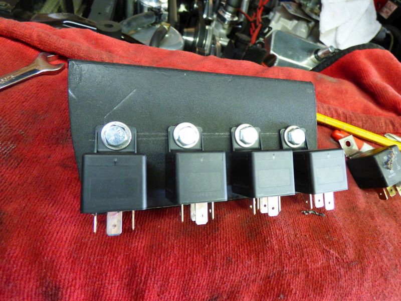

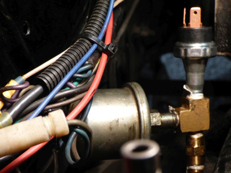

After reading this, and knowing I should have done this a long time ago.
We are in a blizzard warning today so I am home bound,and bored,so I thought I would share what I did.
I t does require some thinking ,and some labor, but it is worth every bit of time and money.

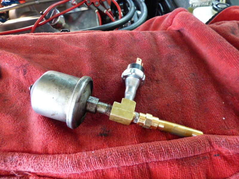

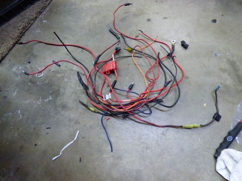

i started with by passing the Amp Gauge,and I had redline gauges convert the amp gauge to a volt meter,(I also had them re do the clock as well as the tach.)and it totally eliminates the alternator wire from the dash ,so I ran a whole new 8 gauge wire to the starter relay, removing the old wire completly.
Then I installed the head light relays, and electric fan relays, as well as an electric fuel pump oil pressure switch,to make the car safer in case of a crash leaving the driver unable to shut of the pump, so if there is no oil pressure ,the pump will not run, this specific switch is from a Cosworth Vega, as those cars had a duel overhead cam and would not allow the mechanical fuel pump ,so yea a chevy part, but I could not find another way to safely use the pump,and this was the easiest way for me.
The fans and headlights work perfectly,much brighter headlights,and now I have all the power distribution on one fender, with 3 mains power studs in line, as well as all my grounds, my grounding block is there due to the age of the car ,and I just don't trust using the body as in the past I have had grounding(earth) issues and this eliminated those issues, so now the car is good on the electrical side,and should provide alot more enjoyment not having to worry about the amp gauge causing issues. :)
P1050516 R.jpg (130.36 KiB) Viewed 950 times
P1050515 R.jpg (94.77 KiB) Viewed 950 times
P1050514 R.jpg (88.97 KiB) Viewed 950 times
P1050511 R.jpg (140.74 KiB) Viewed 950 times
I removed alot of old wire, and replaced it with much larger gauge.
P1050521 R.jpg (111.18 KiB) Viewed 947 times
