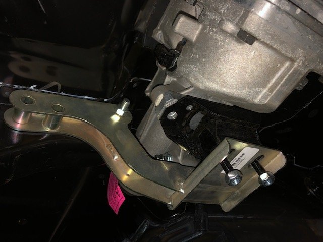

well if that big box fits more or less in a 727 sized tunnel i should be ok with a miniature T5
i just need a rear mount cross member now... SST don't seem to sell one separate so i'm toying with a US car tool one...

Dave999 let me know if you want me to draw a plan of the gearbox crossmember for you ? It bolts to the front of the car crossmember rather than wrapping around it

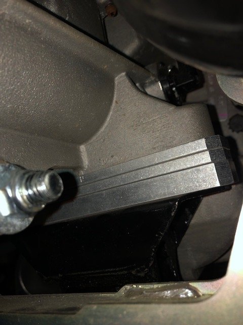

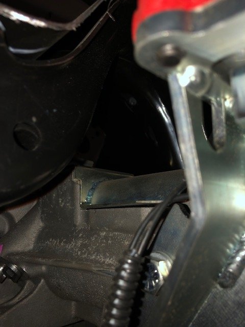

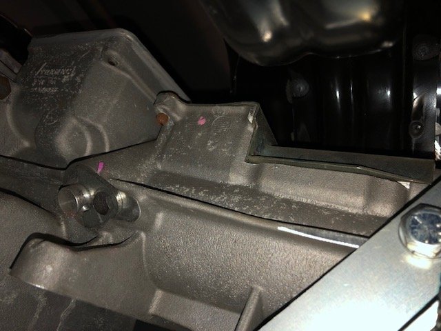

The engine and box are about to come out again so that the car can go back on the rotisserie. Now the roll cage is installed I'm confident I can do more metal replacement on the rotisserie with no risk of distorting the shell.
So while the box is still in I'm taking a final look at the transmission tunnel.
These pics show where the upper rear gearbox case has been modified by SST to clear the torsion bar crossmember, and a plated steel cover fitted over the ground-off area. In the pics the gearbox is dropped about 3" lower than final position .

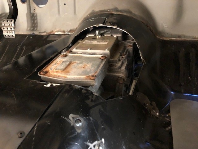

Four spacers (two 1/4" and one 1/2") are provided to raise the gearbox on the mount 'if necessary'. SST claim that factory tolerances vary this much, but I'm not so sure. Looking at the position and angle of the tti header collectors, my best guess at the moment is that I'll need them all. I can just about squeeze them in by jacking the box up till it touches the torsion bar crossmember. Once the weight is on the mount it sinks enough to provide adequate clearance.
Similarly SST provide a paper template so that you can cut a hole (in your tunnel AND new 4-speed hump.....) , to accommodate the gearbox in this raised position. No real problem for this build, but any claims of 'no cutting factory sheetmetal' do need to be taken with a pinch of salt.

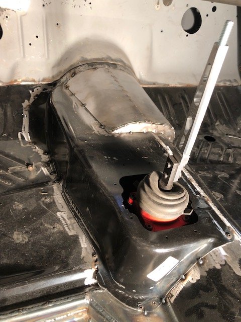

Then I made some sheetmetal to raise the tunnel in this area. It'l be nicely seamwelded before finishing.
