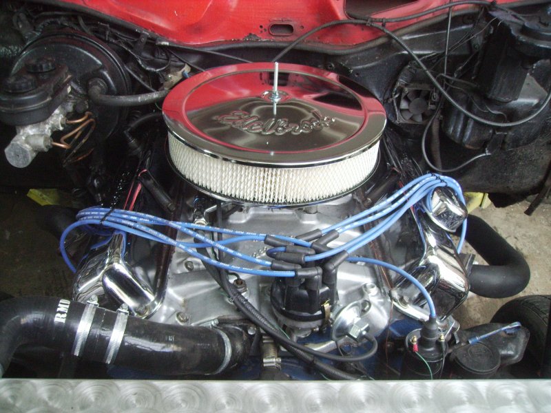

the carb kit and matching (to the rocker covers) edelbrock air filter arrived this afternoon so we can get them sorted tomorrow. that'll allow us to test the gearbox which of course is easier now the prop's fitted and the brakes work.

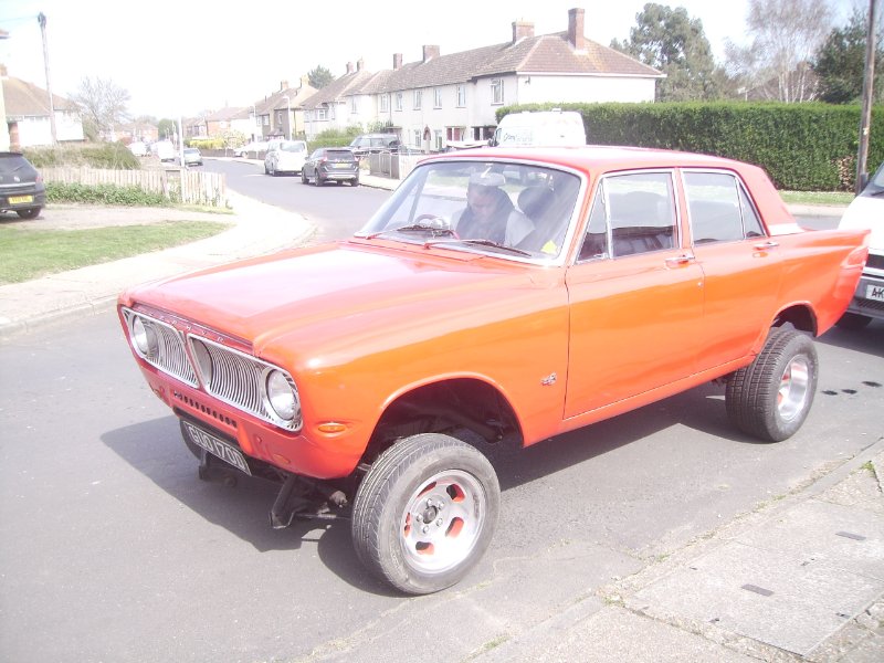

Re: big block to go in ashley's zephyr
and there it is back out in the wild
- IMG_0001 (120).JPG (113.46 KiB) Viewed 21783 times

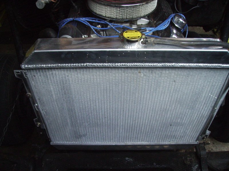

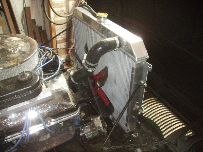

we've got the new big block mopar ally rad' mounted to ashley's zephyr over the weekend. handily the hose fittings are the same sides as a ford fe too so just some minor hose trimming to connect it up. we now have at least an inch and a half between the rad' core and the fan so contact there again is almost impossible.
neil.
neil.
- IMG_0001 (127).JPG (123.83 KiB) Viewed 13765 times
- IMG_0002 (86).JPG (123.26 KiB) Viewed 13765 times
