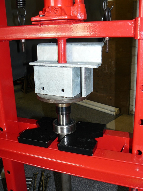

I found the cause of my axle leaks- Crap seals that came with the Strange axles. These have done barely 100 miles and were fitted less than 3 years ago.
I've put my new press to good use removing the old bearings and fitting the new Green ones.
Tiredness kicked in this evening and my brain went to mush- someone remind me in what order the bits go on... gasket then brake backplate then the retaining plate.?

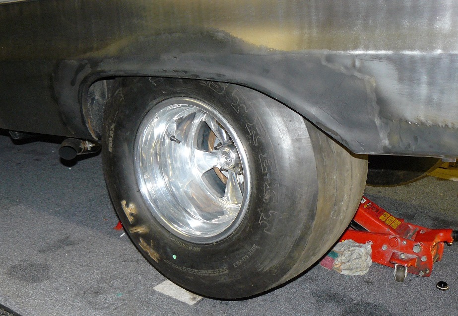

After a lot of frustration I found a local ATS that could cope with my big fat tyres.
New 16.5 x 31 x 15 M/T Street ET's now fitted, balanced and on the car :D
Brakes are bled, axle bolted back on.
I need to check wheel arch clearance carefully!

I had such a blast yesterday :D
I took the car out for about 40 miles to try out the new tyres.
Sooo nice to not have to worry about oil leaks or the wheels trying to shake themselves off the back of the car!!
It just accelerates like a train, smooth as silk, 100+ with no dramas. Lovely!
