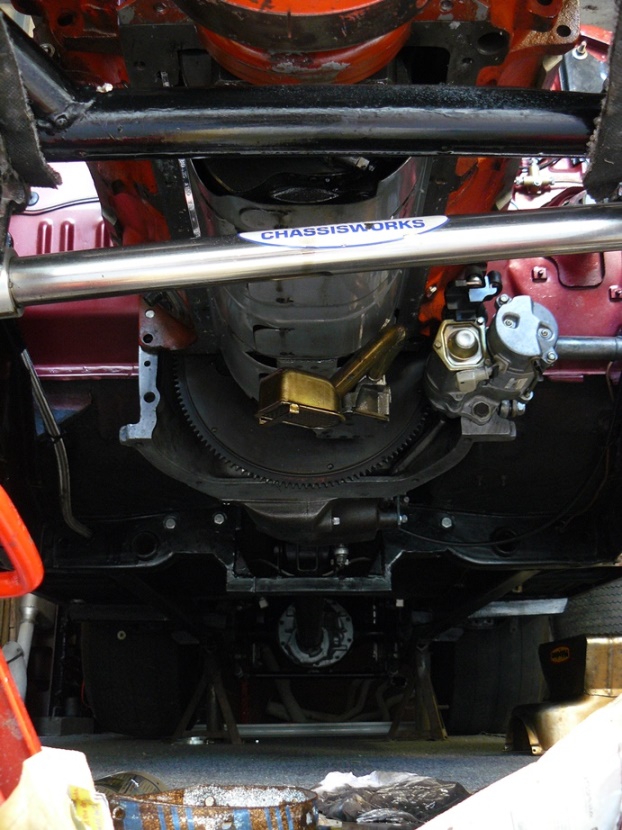

While the car's up I figured I'd do the oil and filter too. As it's also leaking slightly I dropped the sump. An easy job on my car- just loosen the steering rack and drop one end and off comes the pan :D
Nothing nasty in there so I gave it a good clean and flattened the flanges a bit. The end seals are split so I couldn't just re-fit it and I left it too late to order gaskets for tomorrow so the car will be laid up til Monday now :( A frustrating waste of 3 days potential tuning-time :x
Sump taken off.jpg (191.82 KiB) Viewed 989 times

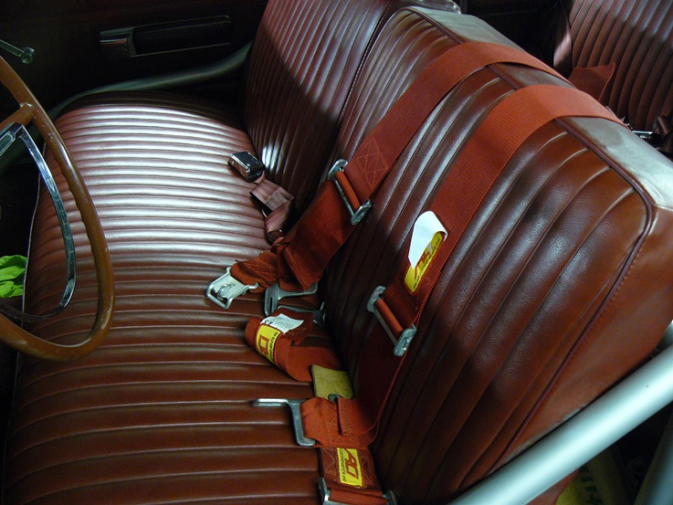

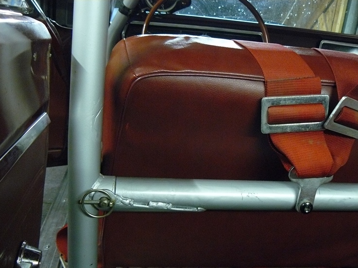

Full harness is in, including the removable centre bar.

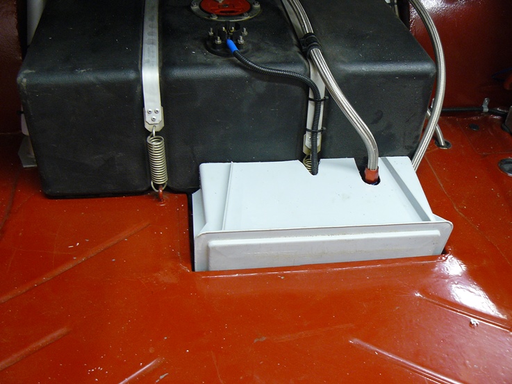

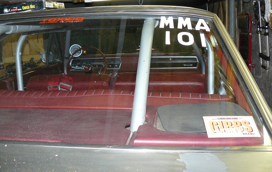

I made a box to protect the fuel pump etc from all the crap I'll be taking to the Pod... and stuck on me race numbers :D
Race numbers on.jpg (251.87 KiB) Viewed 1271 times
Centre bar in.jpg (204.93 KiB) Viewed 1271 times
5 pt harness.jpg (183.38 KiB) Viewed 1271 times
Fuel pump boxed in.jpg (170.06 KiB) Viewed 1271 times

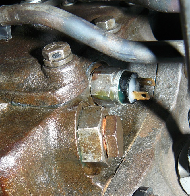

Just putting the exhausts back on this morning and the bloody reverse switch is leaking AGAIN!! :banghead:
Anyone got a spare?
Rev switch.jpg (228.51 KiB) Viewed 1253 times
Switch innards ripped out & filled with Araldite.

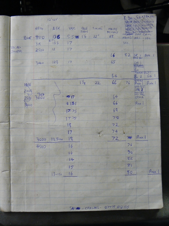

We ended up with 72 primary, 80 secondary. EXACTLY what Les said about 15 pages ago :roll:

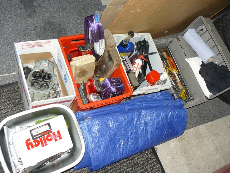

I've been gathering stuff to take, not sure what I'm gonna do with it all once we're there tho...
Stuff to take.jpg (226.34 KiB) Viewed 1104 times
Tuning notes.jpg (174.99 KiB) Viewed 1104 times
