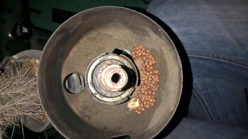

Steering wheel is off thanks to my little home made puller.
I just found a little stash of seeds :lol:
