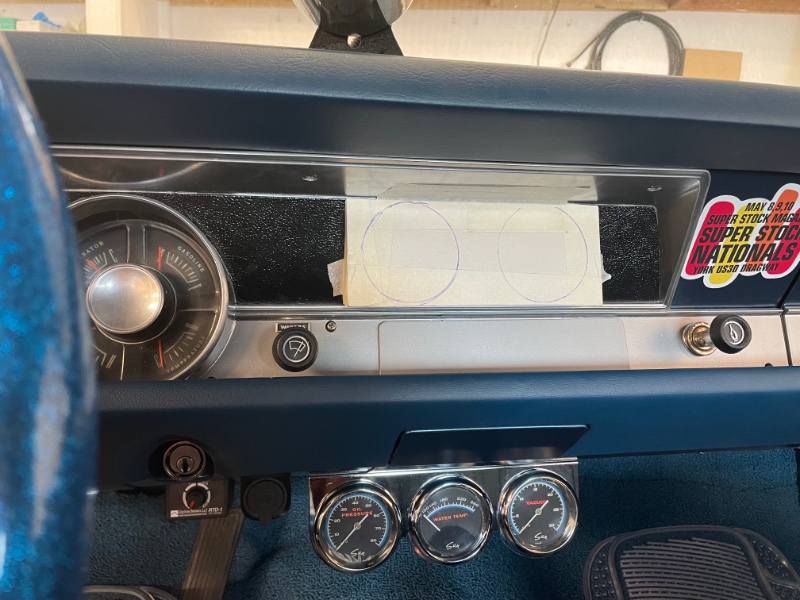

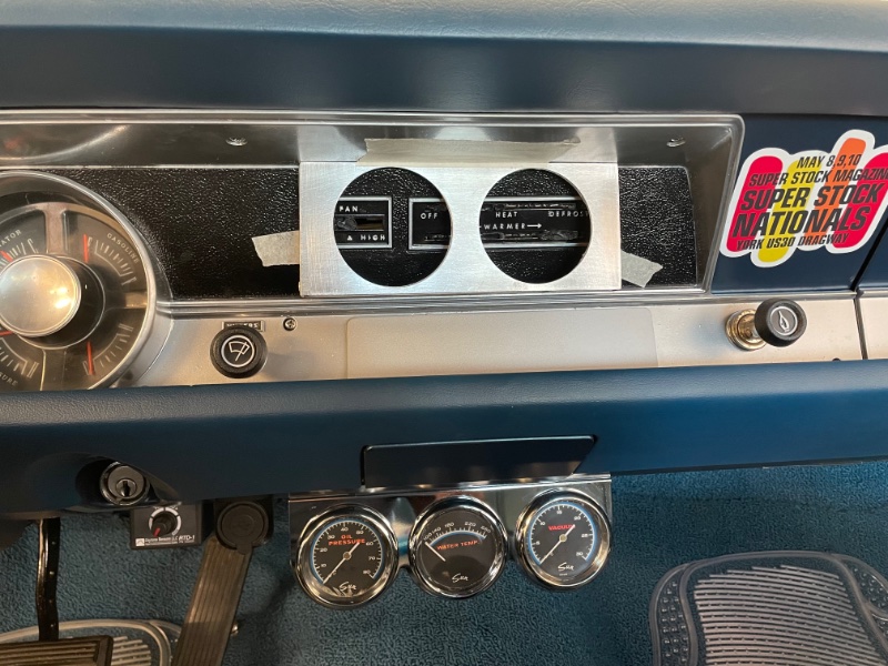

I noticed recently while driving to the Hot Rod Drags I was spending far too much time taking my eyes off the road to look down at the oil and temp gauges, not good. I no longer need a Vacuum gauge so I’ve been working on a panel to utilise the redundant heater control area to house the oil and temp gauges ala Sox & Martin. I’ll change to a mechanical temp gauge as I don’t trust the electrical one and an inaccurate gauge is about as much use as a chocolate fireguard…
Posts: 22138
Re: Blue's Barracuda
Good call, I am not a fan of low mounted gauges.
It is the same with Wiper switches where you have to take your eye off the road, and then have to lean forward to operate them.
I was thinking about a momentary switch (a bit like a dipswitch) mounted on the floor in reach of the left foot....
They did not really "Do" Ergonomics back in the day.....

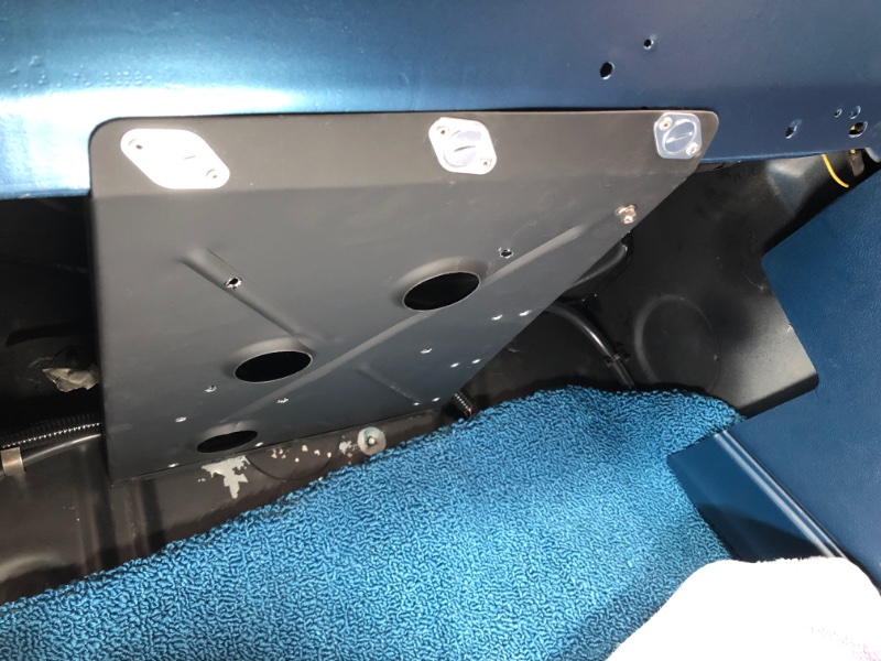

John,
I like your mod with the drop down tray for your electrics. Can you elaborate on how you did it?
Kind regards
Bryan
Posts: 14459
Bryan, it’s 2mm ally sheet, width determined by what you need to mount on it. Folded up to span the gap between the firewall and the underside of the dash at 90degrees to the firewall. This allows it to clear the glovebox liner. A piano hinge is used to mount it to the firewall and 3 Dzus fasteners hold it to the lower edge of the dash in the raised position which isn’t visible from the drivers seat.
rocket70
Posts: 197
Post by rocket70 »
Thank you.
How did you mount the hinge to the firewall….nuts and bolts, tack weld…..?
Posts: 14459
Pop rivets.
