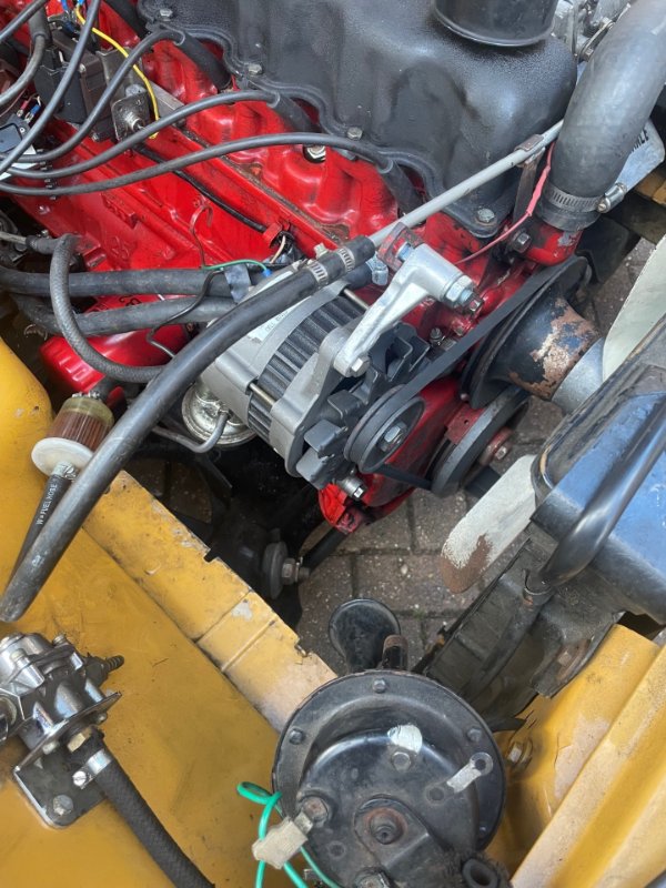

So i have a 4.3 liter six with 1.96 inch inlet valves and 1.5 inch exhaust
can't remeber the lift but its not too shabby either.
ports a big and square and pretty direct to the back of the valve and there is a nice bowled region
size of motor really does point to a 465 holley
but where's the fun in that
i know of numerouse slightly baffled chaps in Oz who swear they have had much more success with 600 vac sec holleys and 650 AVS carters
so we went with an edelbrock/weber version of the AVS.
(note 3.5 and 4 liter Rover V8s like a 550 AVS)
so I needed a manifold
can hack out ya 2bbl manifold and fit a new adaptor but it just makes fuel distribution worse. you end up staying with 3 inch runners to cylinder 3 and 4 and 6 inch runners to 1 and 6 with e near right angle bend in them
get a big whopper my son was the advice
so i bought a hemi hurricane hot out of the foundery
an item that has since been withdrawn due to casting issues. great
So i thought i'd better get on and fit it to see if the casting issues affect me.
have chosen to go a bit old school on the gasket front and am using an expanded graphite gasket as per circa 1930 these have a good 2-mm crush.

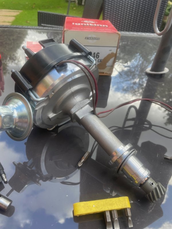

next up is a nearly completed laptop programmable ignition
its got shift light, rev limiter, 3 rev actuated programmable outputs for triggering things..................................
bunch of flowers at 2000 rpm
tea and toast at 3k
and raise the antenna at 5k
ten BINs BINS??? well bits to say what happens and when
two maps switchable on the fly from a wee button on the gearstick or wheel if you so desire.
interpolates between bins (soon)
1/16th of a degree accuracy and multispark under 3000 if i get the right bit of V6 Ford Mondeo.
Gotta be easier than welding slots and messing with springs.
recon it will cost about £150 and about 10 hours work all up.
