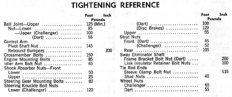

Hey mates can any body gimme the torque settings for the lower ball joint nut and the two bolts that attach the joint to the spindles please? Me Challys just been Mot'd by me cousin and he said they were proper Bananarama! so he's just fittin two new ones but I don't have access to a manual, tried online but can't find jack :roll:
Cheers Ade :thumbright: [/u]

Any good?

Thanks Davenan that's brilliant ;)

Sorry mate. Let the side down a bit there. I was ages trying to find the link to my online manual. :oops:
