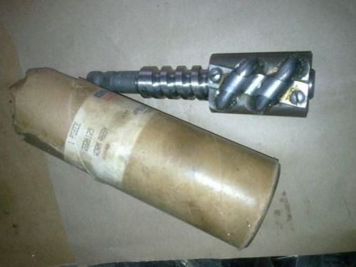

ballnut and worm shaft as seen in picture below get one with fat threads 20:1 or 16:1
that has no corrosion on the threads or the bearinng seats
it rides on 2 ball bearing races
like these (not saying these are correct youd have to ask)
http://www.ebay.co.uk/itm/200294209421? ... 1438.l2649
1 sector shaft a bit like this (no idea what its off has potential but a risk)
http://www.ebay.co.uk/itm/281027223035? ... 1438.l2649
and either 2 brassy/bronzy type bushes for the sector or 2 sets of needle rollers depends on vintage of box
there is a seal for the sector shaft at the bottom of the box which involves a trip to a bearing place to find and tapeing over the sector spline so you don't rip it when you build the box.
if you are buying new stuff
this is a reversed saginaw 525 box.
the splined end of the steering worm exits the box through the bearing preload adjuster, just about every other OEM using saginaw boxes or designs has that splined end come out the other end of the box.
any ballnut and screw you buy needs to have a thread going the way shown in the picture below and will have 1 clip for the ball guides held down with 1 small bolt not 3.
if you get one with the other thread and 3 hold down bolts when you turn your steering wheel to go left the wheels will go right
alright for a clown no good for the road.
ballnut and screw (Medium).jpg (213.22 KiB) Viewed 1166 times

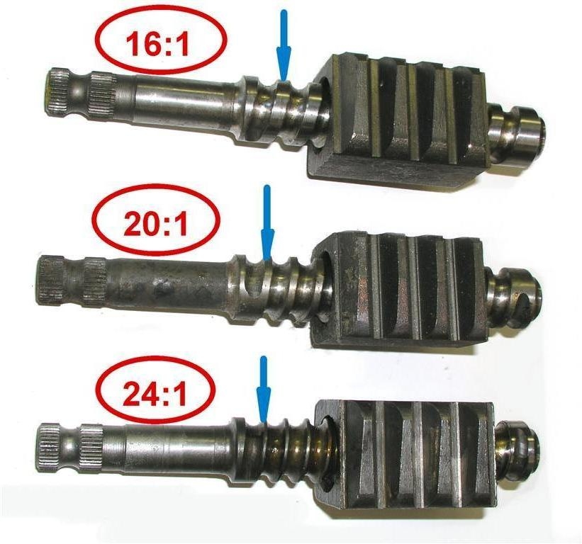

Posts: 9592
example of a ballnut and screw you DON'T want
looks good
deffo 16:1 ratio
but the thread is the wrong way and you have 2 screws holding down the ball guides
this is for a truck box for a situation where the layout is more Cab-Over and the box has its pitman facing the oposite direction
i.e fit it to you car and get you left and right the wrong way round
ratio and direction of steering is all in the ballnut and screw
ballnut truck d100d2006065.jpg (23.98 KiB) Viewed 1162 times
