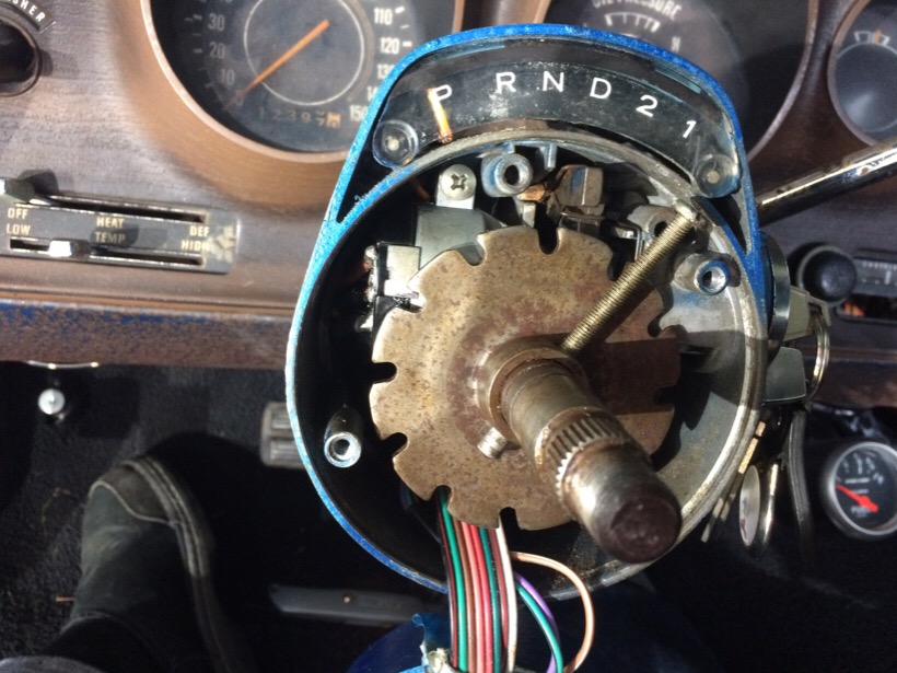

Hi guys, fitting a new ignition switch but having a bit of trouble getting the column apart. Managed to get the bearing and snap rings off, but I'm stumped when it comes to the lock plate. I assume that is what is called, the circular, saw blade looking thing. Any tips? I saw on another forum they used a special tool, but I'm hoping I can get it off without a special tool

Yes I've done this job recently. The big jagged locked ring plate is held in place by a pin. You need to drift that pin out and then you can remove the lock plate. After that it's easy to remove the ignition switch and barrel.
Don't forget to lower the steering column so as to make removing/refitting the switch easy. It has a junction block which is a bit of a fiddle to squeeze down thru the steering column head. I posted some pics of the lock removal a while back in winter/spring this year.

How'd you manage to get the pin out? Also, the switch you got from rock auto, don't suppose it was a standard brand switch was it? Mine seems to be wired the wrong way too.

You have to punch the pin out - there is a cover that you have to prise off first.

Cheers Pete, I managed to get the cover off easily enough but the pin won't budge. One side seems to be longer than the other and sticks out slightly

I used a press, Duncan would probably use his teeth...

Tried a hammer a few times, doesnt want to budge. I have seen there is a special tool, but i assume they are few and far between

Chris, I drifted mine out in five minutes.

Last time I did one of these I disconnected it from the box and slid the inner shaft up rather than batter the lock ring off.

I made up a piece of Tiber that held the shaft safely so
no abuse took place. To be fair, the drift I used was exact and made the job easy.
