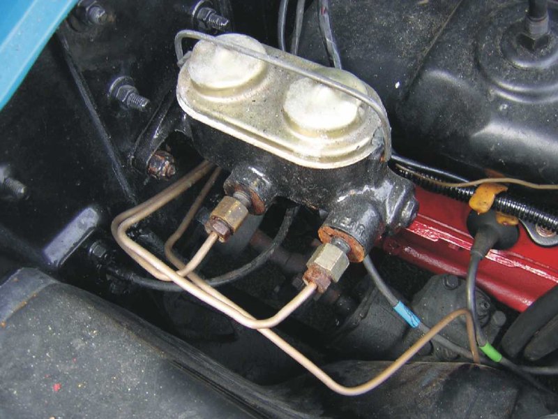

Does anybody know where in this country one can order brake pipe adapters like the ones in the picture going to the master cylinder? I've looked in vain on-line and my local garage can't get them. The thread going into the master cylinder is 1/2" X 20 UNF and the internal female thread from the brake pipe union is, according to my notes, 3/8" X 24UNF.

if that's the original style master cylinder for the car then the tube nuts were probably the correct size for the holes originally
and someone has made do with what they could get and an adapter
my master cylinder has a big connector and a smaller connector that go right in without adapters
i'd suggest this is standard mopar stuff
the internet says
Small one is 1/2"-20. Large one is 9/16-18. Both for 3/16 brake line
inverted flare
potentially these
http://www.summitracing.com/parts/aaf-all50114
http://www.summitracing.com/parts/AAF-ALL50115
but can't promise, didn't buy that stuff
as i just re used what was there
Posts: 9611
Re: brake pipe adapter
ah the ports on your master are both the same size.
are you replacing the adapters or just looking for tube nuts to go into them?
id order some from https://automec.co.uk/collections/fitti ... ttings-unf
and send back the ones that don't fit
you can start them into the thread without taking them out of the poly bag
they do a 1/2 x 20 3/16-pipe, tube nut
cut off the ends put new ends on flare and bolt straight in rather than have adapters
or phone them, send them one and they could make the adapters
