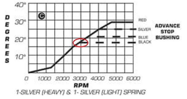

So - Job one. Changed advance bushing to largest 'black' which limits mechanical advance to 18degrees total.
I then changed the spring rates to give me full advance at 3,000 rpm (see graph).
This now works - I have set car for 16initial and watching the revs she hits 34degrees total at 3,000 on the nose and stays there.
She runs nice and seems happy to start. Happy days.

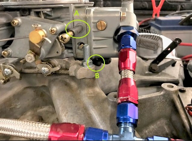

Here is where the fun starts. As soon as I unblock the vac can and connect either to A or B on pic it goes nuts. BANG ! intake backfire as soon as you touch the throttle. I cant even get a reading off of it with the gun. So at this point I dont know if its dizzy prob, vac can prob, carb prob (although its worth noting the problem has followed from old engine to new, and the carb is different so it points to dizzy/can).
I can see the internal of the dizzy move when I suck on the pipe. I'm a bit lost to be honest... :-k
Any bright ideas or do I need to speak nicely to a tuning shop (thunder road?? :) ) and just get them to set the thing up properly; carb and vac ? I need to get it sorted as it will make the car so much more usable when I am not panicking about traffic jams ! :-)

It sounds like the vacuum can is pulling in too much extra advance, to the point it's probably sparking on the next plug lead on the cap. You can normally adjust the vacuum can by poking a little allen key up the nipple, google will help you here. Running on? possibly the primary blades are open too far. Ajust the primaries until you have a square transfer slot and then leave it alone, adjust your tickover speed with the secondary screw. Even if that doesn't fix it, that's the correct way to set the carb up, much crispness of throttle will result.

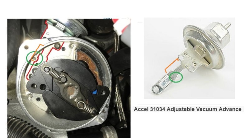

OK. Next plan - as this is starting to annoy me.
Forms all over the place seem to be full of "No, MSD dont do an adjustable vac can. Not compatible with anything else. Rumours of various fits etc..".
So here is what I have found. The Vac can looks a dead ringer for an Accel31034 to me.
The body is the same, bolt holes the same, even the circular stamping on the wide bit.
The only difference I can see is there is a little dent to clear a bolt or something on the MSD - but it looks like something I could file into new vac can. Only question seems to be the neck length. Is it the same, or is the MSD a *tiny* bit longer? Cant tell really. :-k

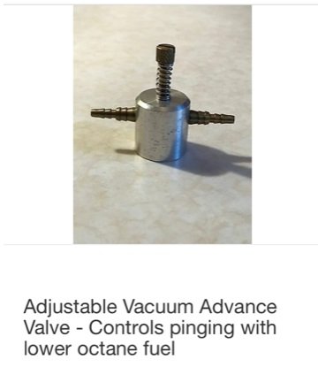

The only other option I have come up with is this little thing. Claims to be a vac reducer; I know I am getting WAYYYy too much, so I only need to adjust down. Whaddaya think ?
Posts: 14658
Re: Timing - 440
I think how well that valve thing works probably depends on how much vacuum the engine makes at tick over, if its not a lot anyway...

The vacuum can must be connected to the ported vacuum connector. the one above the throttle plates. it should see no vacuum at idle and add no timing at idle.
it should see and full vacuum with the throttle plate just passing the hole that leads to the tube for ported vacuum. but the level of that vaccum is dictated by RPM and engine load
