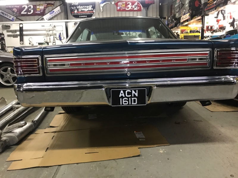

Refurbed the trunk panel trim, being coated ali had to try to buff of the coating but looked crap after so spoke to a couple if metalisers they reckoned the only solution would be to chrome it but cost was ridiculous si had it chrome powder coated then vinyled as painting would have cost loads with the masking looks ok not as new but a s/h unit is 1200$ + shipping and that aint perfect if u can find one anyway it will do

Looks pretty damn good to me. Quite an elegant solution really. I mean I can see the purists might have issue but it books great, its modern, and easily repeatable if needed. I think thats a top job. :thumbright:

tks my thoughts as well, if it gets knocked can re P/Coated

Looks graet Jon, I'd be happy with that.

Agree, looks very good, and probably what Mopar would do if they were making them now, modern materials etc.
