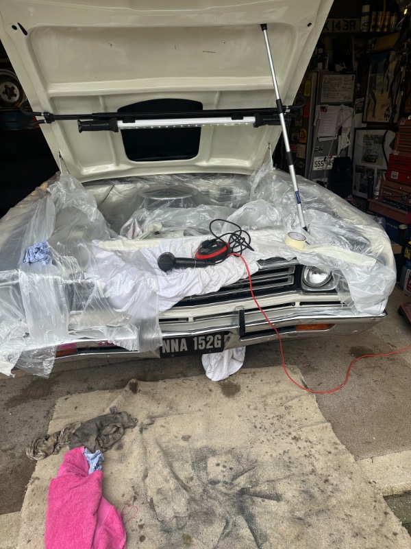

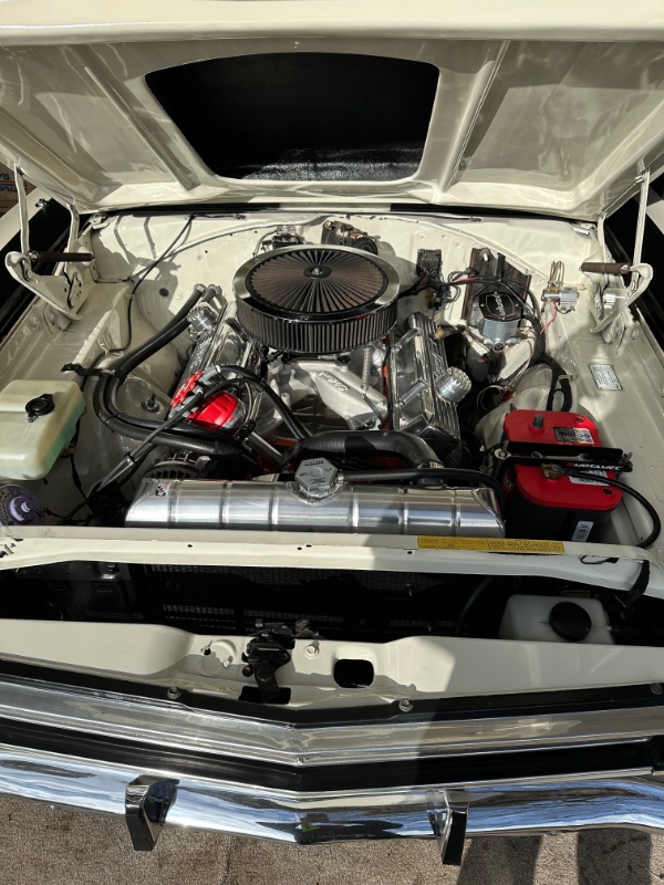

I’ve done a fair bit on mine in situ,as Dave says lots of masking and various things removed.
I used VHT in orange and black,with regular satin black for non heat affected parts.
What I did find useful was body shop masking film in a roll,great for those tight spaces.
Brushing in some areas is inescapable,and heat to prevent reactions and runs is essential.
Polish that Ali don’t forget 😉
