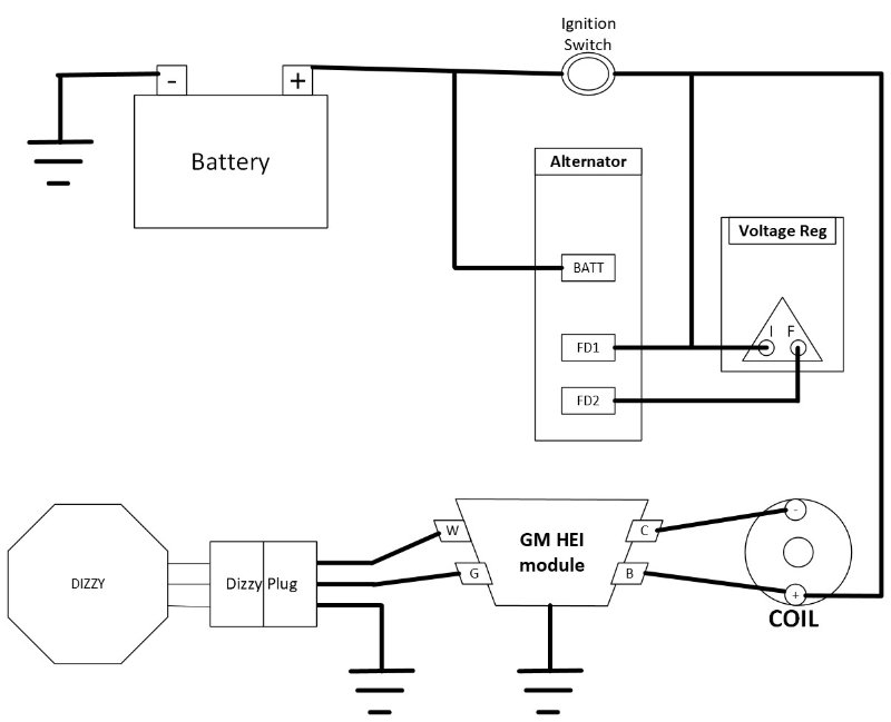

OK - Engine out, engine gone, 12v-all-in-1-MSD-dizzy gone with it.
New engine in, just wiring up.
As I looked at the newly supplied orange box and the ballast resistor I just got a sinking feeling remembering all the pain. Do I REALLY want to go down this road again...? I remembered in the past the view of 'Get rid of the ballast, stick an HEI in there, 12v to the coil - boom - off you go.
My coil is an MSD blaster2 - so 12v - I really want to feed it 12v. Reading up over the weekend I think its actually not too bad.
Using the voltage reg that I have (which fed the 12v MSD previously) I reckon the new setup could look like THIS.
Could someone sanity check it. Seems too easy. But given the coil and voltReg are both suitable...
thanks !

1 - The diagram at the top is correct. This is a simple way to ditch the ballast and the orange box.

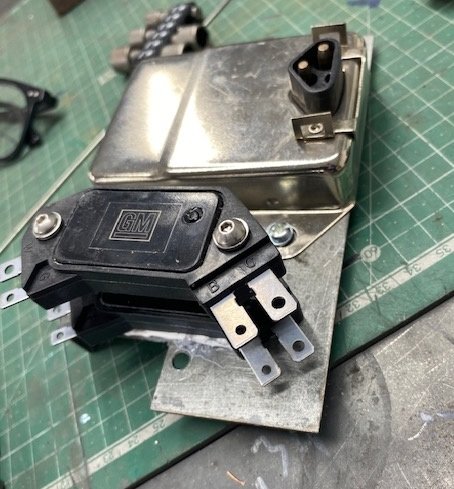

Funny think was I KNEW the module was the questionable bit - but 2 of them... threw me. (ignore temp wiring)
I'd even double stacked them anticipating a roadside failure at some point. Lots of space , heat paste, airflow and gaps.

that wiring will be fine....

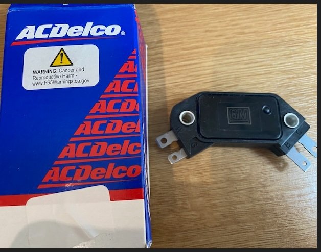

Soooo - AC Delco ones arrived today. Guess what ? Stamped up as GM OEM !
I now have 3 of these and a Lucas one on the way. Belt , braces and sock suspenders.

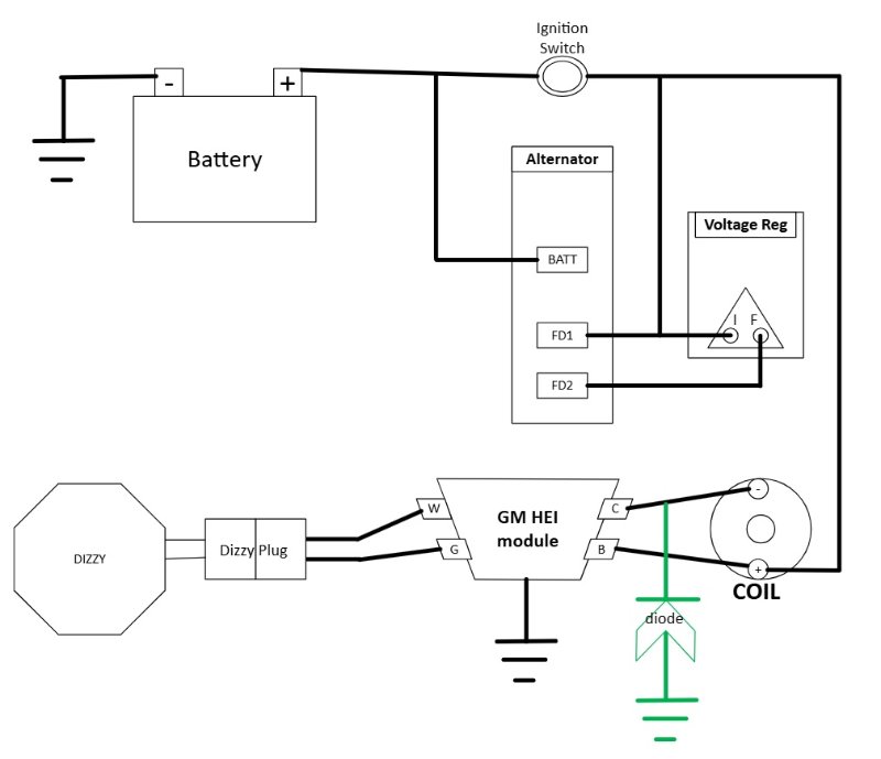

Good tip on the Diode - Looking at it now. Seems a no brainer; will update diagram for reference.
sooo - like this ? (green)
Posts: 9615
Re: HEI module swap ?
Yeah. That should do the job.

Mounted. Double stacked. Trimmed. Spare spade ready for new diode. Fingers crossed...

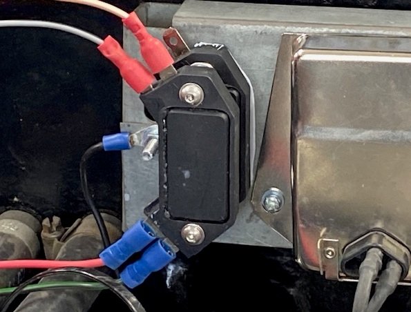

Installation has double stacked HEI modules just-in-case. Only thing I have to add is the diode for protection (on its way).

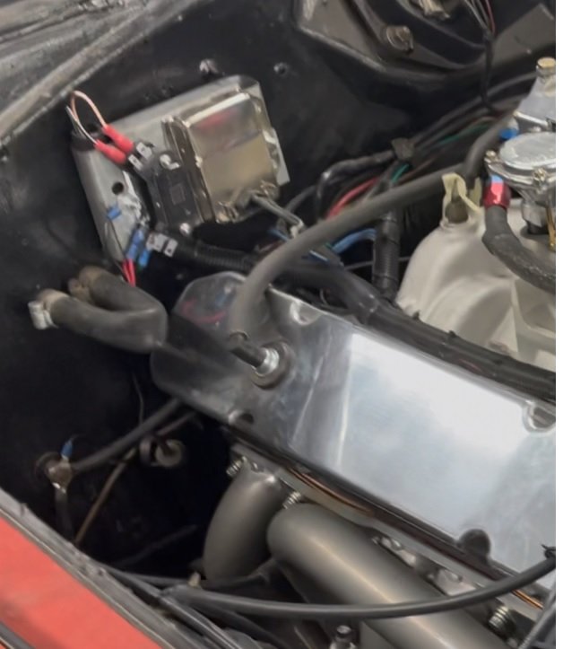

Excuse the quality of the pic - but final install, with earthing and airflow.
