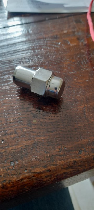

wheel nut.jpg (109.94 KiB) Viewed 74043 times
I'm running Autodrags on my cuda - 10x 15 rears with 325 x50x 15s on the rear. The springs have been "inboarded" though. The centre of the hub is 1" thick. The wheel nut pictured I'm using is 1 and half inch long and I'm using a flat washer. The nut is stamped 1/2-20 LH. I got them form North Hants tyres who are very helpful and carry stock. I think my front street wheels (also autodrags are 8x15. Hope this helps
