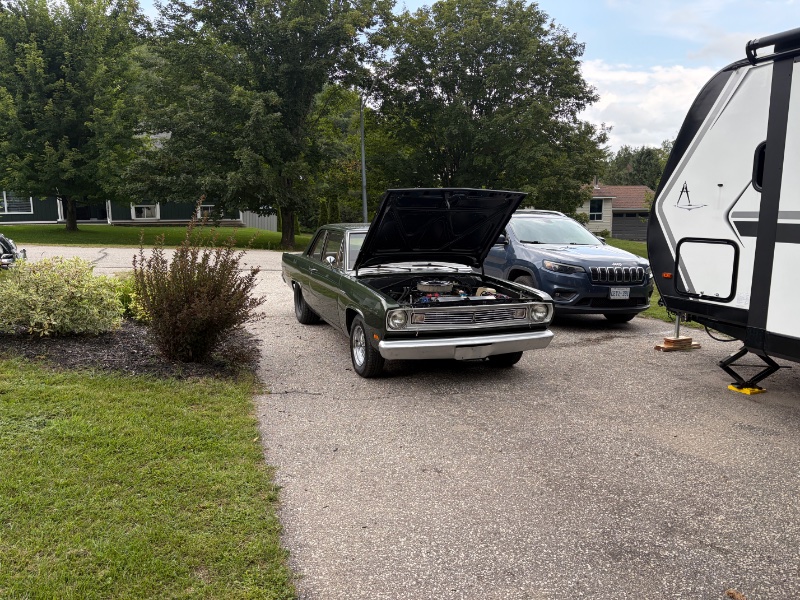

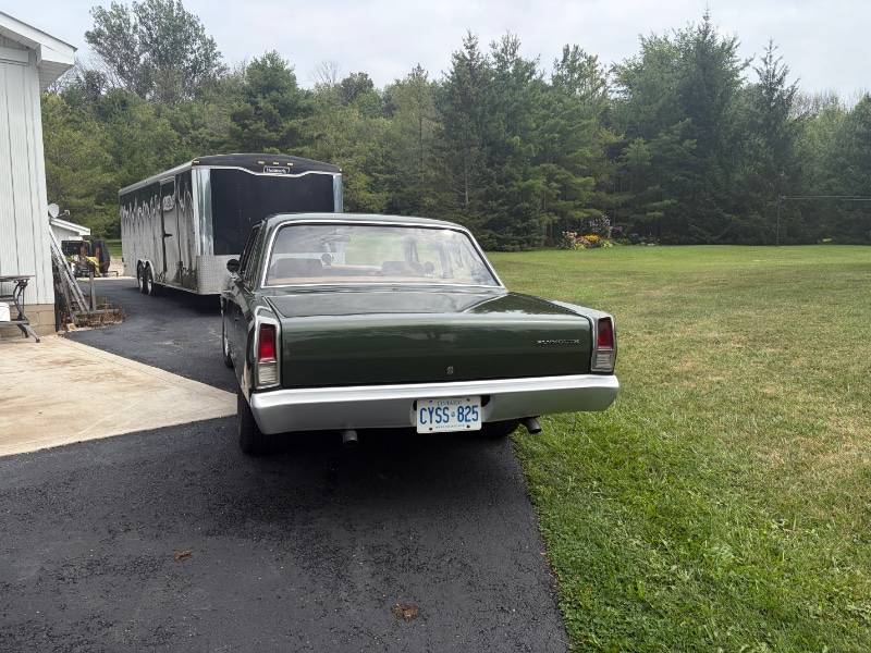

Got the car home today, went over it with Billy this afternoon.
Found a couple of things it needs.
Windscreen washer foot pump is leaking. Sounds like a common fault. I will replace the rubber foot switch with an electric one. Stop water from leaking on the floor.
The other problem is a bit more complicated.
There is nothing in the rearcend that acts as an emergency brake.
I need that for our version of MOT. The backing dust plates are home built, and the thick metal items that hold the e brake shoes have been ground flat. Looks clean, but it won’t pass.
It is an 8.8” Explorer rear end. And getting all the hardware ain’t that easy!
We thought a hydraulic e brake may work, but I think, that will not pass either. Will chat with tester next week.
But, it drives great, handles well, body and underside are just amazing! And the sound, really takes me back to the old Coronet days.

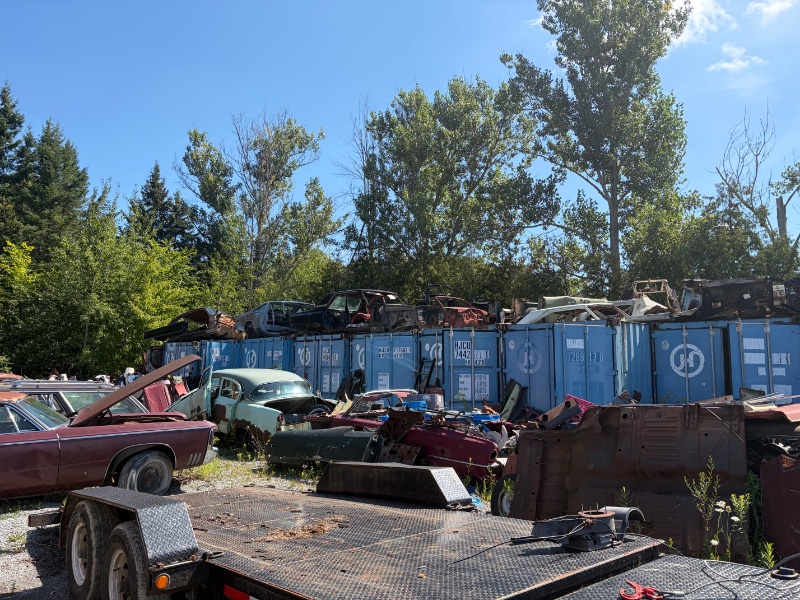

Today I went to national moparts. It’s only 30mins away.
Got some defrost vent tubes, and some parts for the windshield washers.
