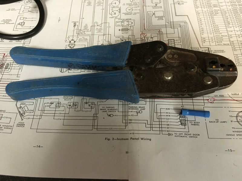

I was thinking of the ratchet type crimps with the blue plastic outer (for 2.5mm cable)? I am routing the alternator feed straight to the starter relay and connecting the ammeter cables together (I'm using one of the posts of the ammeter for this connection. I'm hoping the cable I ordered will be here today/tomorrow.
XP29
Posts: 882
Location: Harlow, Essex
Post by XP29 »
This type of crimp and this ratchet
Posts: 6745
The crimps are OK, but there are a lot of Chinese type copies on the connectors, so be careful what you use/buy. They don't seem to crimp/hold with the same force of a good crimp
For connections to starter motor, alternator, I prefer to use the alloy type which uses a different crimp method. These are sized to the cross sectional area of the wire & to bolt they are being affixed to.
They may not be the cheapest, but I have been very pleased with quality of the cables & connectors I have bought from ECS
