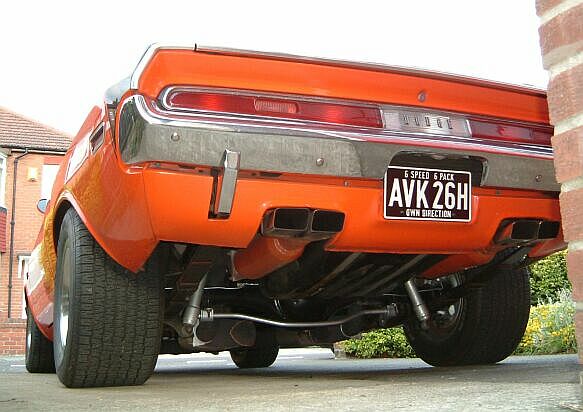

Exhaust
Dougs headers with 2 inch primaries into 3.5 inch collectors. TTI 3 inch exhaust system with two Dynomax Super Turbo mufflers. System cut into 18 sections and re-welded to fit around overdrive and to include electric cut-outs and a wideband Oxygen sensor for air/fuel ratio monitoring.

Original 8.75 inch “Sure-Grip” axle. Rebuilt with 4.30:1 gears. Effective rear ratio with overdrive engaged is 3.30:1.
Brakes
Original 11x2.5 inch drums on rear. 1976 Police car 11.75 inch discs fitted to front. Strange Engineering light-weight master cylinder. Power assist removed.

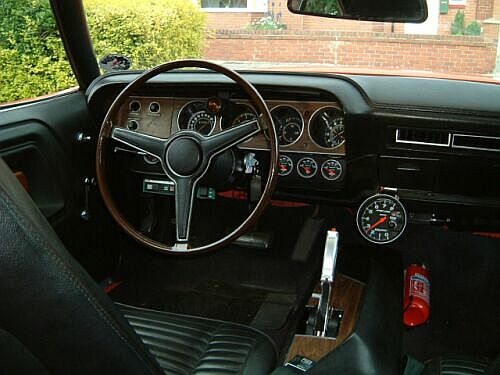

Auxiliary gauges fitted in dash for water temp, trans temp and volts.
“Monster” tach with remote shift light fitted in dash above steering column. Headlights and turn signals to UK spec.
Interior woodgrain trim replaced with carbon fiber panels. Grant steering wheel.

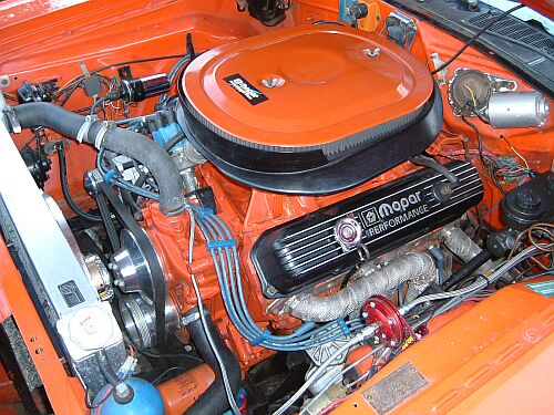

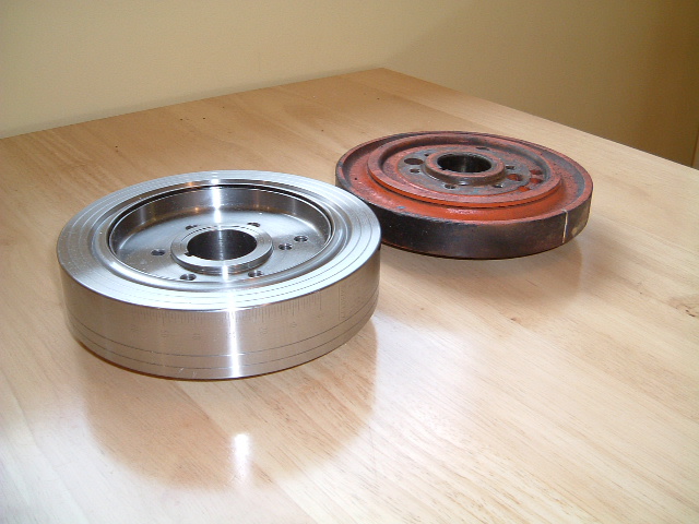

Any changes from the above spec will be listed here as and when they happen.

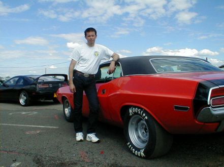

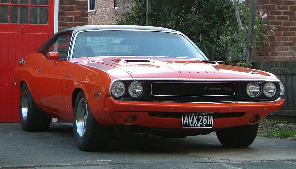

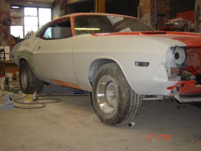

1st update is it is now fitted with T/A spoilers front and rear. A new EAGLE Nitrided Crank is on it's way over from the USA to replace the damaged original.
This is how the car looks at the moment.

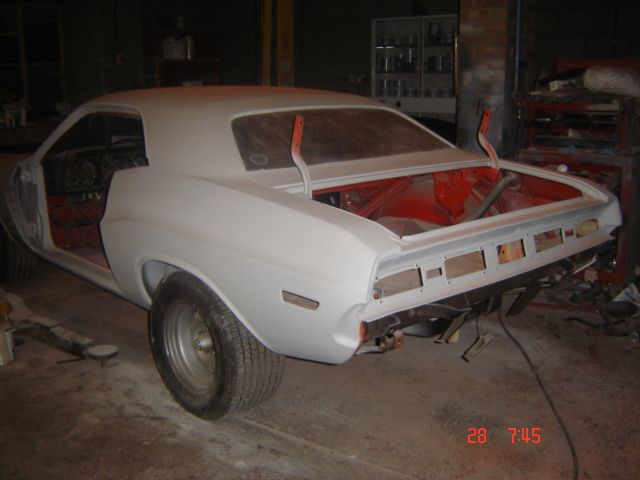

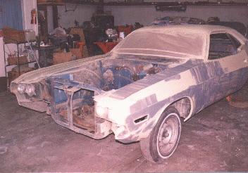

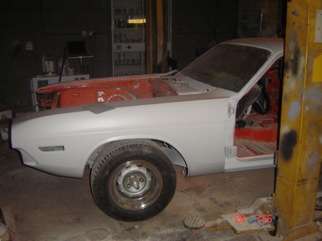

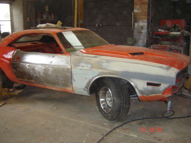

A bit of History.
I had this 1970 Challenger imported from Texas in 1989. It is a real R/T with numbers matching 440 Magnum engine and trans.
There were 18,512 Challenger R/Ts made for the 1970 model year of which 2,802 were two door hardtops equipped with the 440 Magnum engine ( which was only avalible in the 1970 model ).
916 were 4 speed manual cars.
1,886 were 3 speed automatics like this one.
It was originally a (B5) metallic blue car with a white vinyl top and a white interior both of which were ruined. It had some front end damage and needed a new boot (trunk) floor when I put a deposit down on it in May? 1989. It had not ran at all for around 5 or 6 years.
I had wanted a car that was painted "Hemi Orange" and so decided to have it painted that colour rather than the original colour. Also for practical reasons I decided on a black vinyl top and interior.
This is how the car looked as work started in May/June 1989.

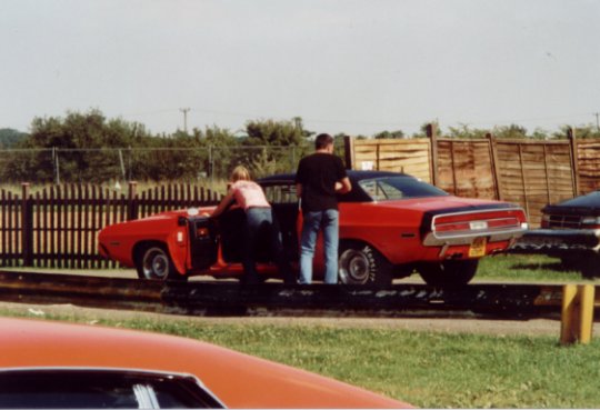

I really need to see the car soon. I am missing it so much!
Here it is on it's first 11 second run up against Tim Ellison in his yellow Challenger.
http://challenger.mpoli.fi/hauki-on-kal ... -small.wmv
And here it is showing Tim the difference between stock suspension and mine.
http://www.challenger440.pwp.blueyonder ... andTim.wmv

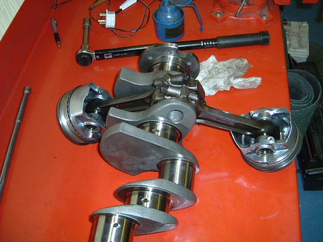

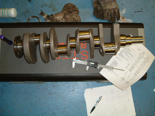

And here is the crank at long last!
Thanks to Wil and Andy Neal for their help in getting the crank over here for me.
Everything is checking out fine so far. Straight and 10 thou under just as advertised. I have just ordered the bearings and a new harmonic balancer for it.
Next step will be to get the whole thing balanced but I need to save the money for that.
Unless any of you guys want to buy a 1998 Neon by any chance?

- Dave-R
- Posts: 24752
- Contact:
Did a few checks on the crank this afternoon because I
absolutely still cannot be bothered to finish decorating!
Everything is spot on. Main and rod bearing clearences
are exact to the prefered spec. The alignment (or
straightness) of the crank is spot on.
The only bit that is not as tight as I would have
liked is the crank end play. It is 8 thou (2-7 thou
prefered and 10 thou max allowed). But that is a hell
of a lot better than the 64 thou we were running with!
I used a feeler gauge to check that. It occured to me
later to use the dial gauge on the crank end. I will
check it again when the whole crank assembly is
complete and installed correctly.
- DSCF0007.jpg (63.68 KiB) Viewed 139567 times

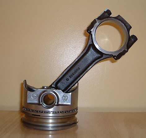

After much thought I have decided to keep the existing rods. They may be 36 years old and they may be heavy but they have done OK up to now and they are also the last internal part the engine was born with.
- DSCF0002.JPG (47.51 KiB) Viewed 140087 times
