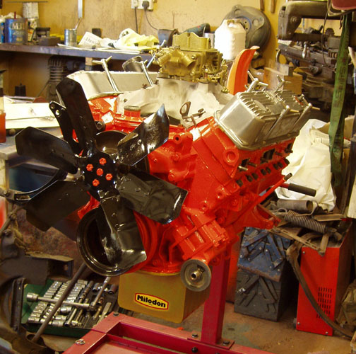

Posts: 13002
This is how my RR motor turned out etch primed and two packed...the flaking occurred around the head flanges, but otherwise it looked superb!
Wolfman
Posts: 608
Location: Walton -on-Thames
Post by Wolfman »
Ivor wrote:This is how my RR motor turned out etch primed and two packed...the flaking occurred around the head flanges, but otherwise it looked superb!
Now that's what I am talking about :thumbright:
