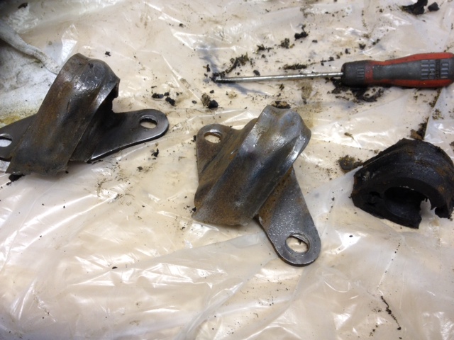

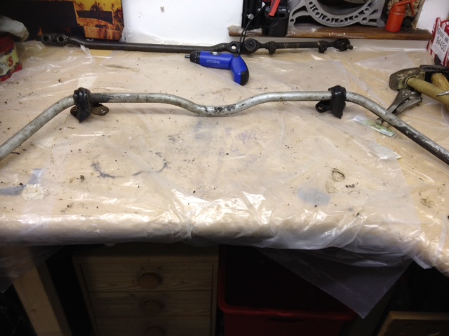

Did a few more bits today (actually got a couple of hours). Decided to tackle the front ant-roll mounts. (getting the new ones in is going to be a hoot. Some end up splitting and re-welding. Still, we'll have a go... )
Here it is before I started. Took me ages to drill and dig enough of the old rubber out to remove the mount from the bar, but eventually they came off. WD40 is your friend !

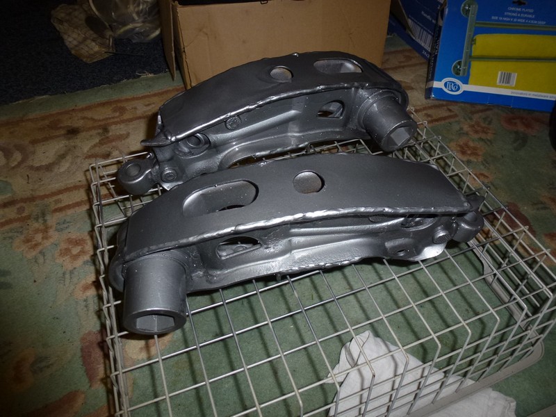

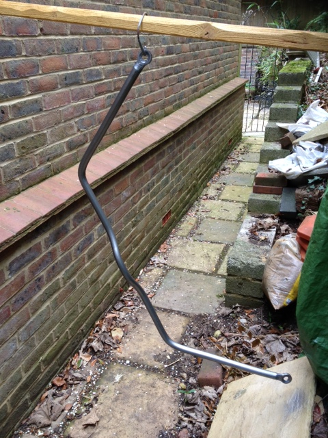

Spent about an hour with a wire brush on a drill stripping and polishing the bar. Had its first coat of paint - like the suspension arms I have used an alloy wheel paint. Moderately durable, and a really good colour, sort of dark silver - touch of gunmetal. The mounts are being painted black.

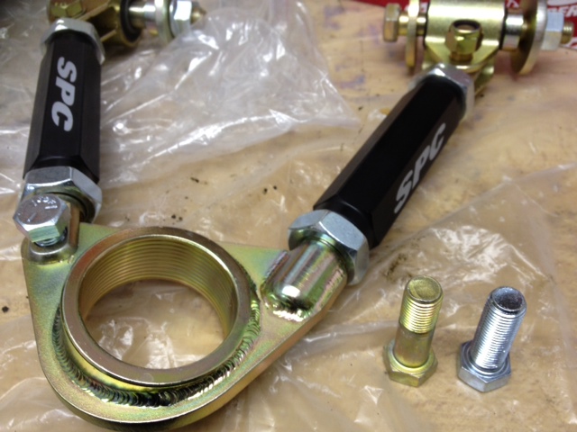

Also decided to tackle the new UCA. Basically, having sought advice, I have concluded that the lovely control arms were let down by the bolts. The small bolts shown were just that, threaded bolts. This has got to be subject to wear, having a thread. Decided to source some shanked bolts (gold ones below). Had a bit of a result actually, found a GREAT supplier to EVERYTHING bolt wise (Trident, based at Silverstone). Took the arms along, explained my issue, they dug out some mega high tensile aircraft spec bolts (stronger than the ones supplied).Job done (or so I thought).
Of course, being American grade engineering
naturally the bolts didn't quite go through all holes - some were a couple-o-thou too small
. Basically, what I did was gentle ticked around the edge (like a de-burr) using my pillar drill and took *just* enough out for a lovely snug fit. Job done.
Nothing ever simple huh ?
- card.JPG (115.76 KiB) Viewed 1938 times

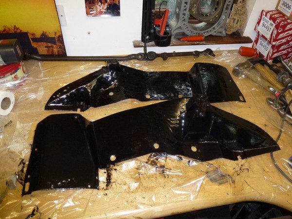

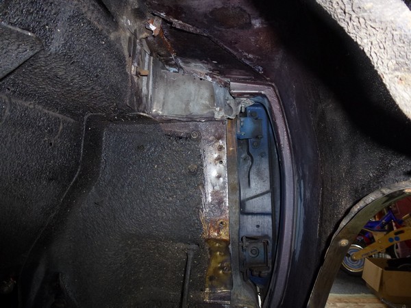

First off was the spash shields. Mine were a right state - been meaning to do them since I got the car many moons ago. Came by a set on the forum, so set about minor mods to fit the charger. Basically it meant fitting a little mount for the wind (different on a charger to a RR). Came up really nice though.

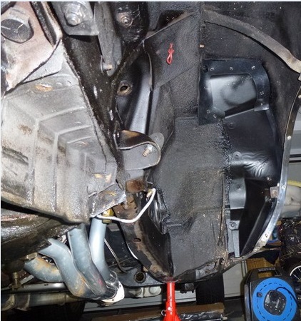

The void behind the old shields (which I was sort of dreading) turned out to be in really good nick (phew) so that got a quick coat of metal treatment and a minor waxoyl spray. Looks great.
New rubber were from ebay (DMT - Detroit muscle technology) repro and fit great. Looks 100 times better. V pleased.

- New ones in, rubbered. Looking good.
- tn_3_newsplash.JPG (92.91 KiB) Viewed 1892 times
- The void. Surprisingly good. Note the blue - one of her many prev colours...
- tn_2_void.JPG (85.36 KiB) Viewed 1892 times
- Newly blinged and modded splash guards.
- tn_1_splash.JPG (89.55 KiB) Viewed 1892 times

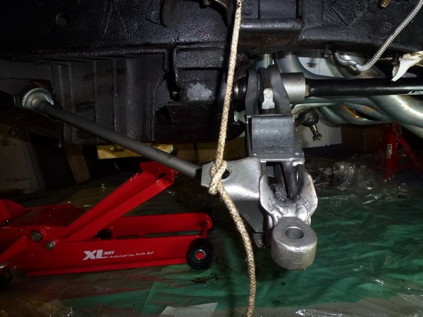

Slowly slowly.
Yet to find a piece that goes on in less than 2 hours. But its on the way. Bit stiff to move at the moment (tightish fit) but will calm down.
The adjustment on these things is epic. I reckon I can move then 2 inches fore and aft just on the threads !!

More to bore. Slowly monkey.
Interestingly, side 1 took weeks. Side 2 took 2.5hours.
Easier when you know the order, mods and pitfalls aint it ?
- Ooh these things are devils.
- 4_buggers.jpg (70.43 KiB) Viewed 1770 times
- Side2. Much easier. (although I forgot the torsions first time. Doh. Minor cockup.)
- 3_side2.jpg (97.92 KiB) Viewed 1770 times
- Getting on.
- 2_uca.jpg (128.06 KiB) Viewed 1770 times
