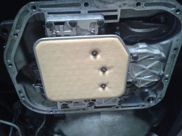

He's also done me a huge favour and replaced the leaking selector gasket on the tranny......(I'd not have a clue where to start, so decided to pay for expertise rather than Bananarama! it up)) :thumbright:

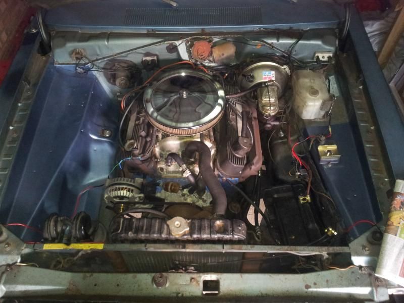

Pulled the Dash AGAIN for the third time this year (non working speedo) and now have that sorted!
Rewired the MAD conversion for ALT to Battery with bigger Gauge wire and routed to the rear rather than the front. Added fuses and tidied wiring!

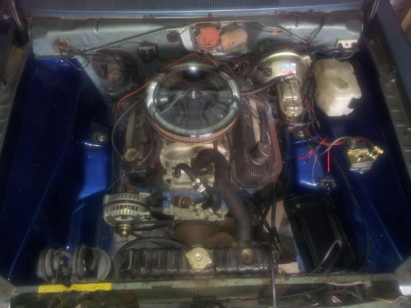

Decided that since I'm going the whole hog with this car I would test colours in the bay area. This happened months ago with a VW colour. It was closest match by eye (i was far off) to what the car is now. Nope don't like plus it was a quick hatchet job by me!

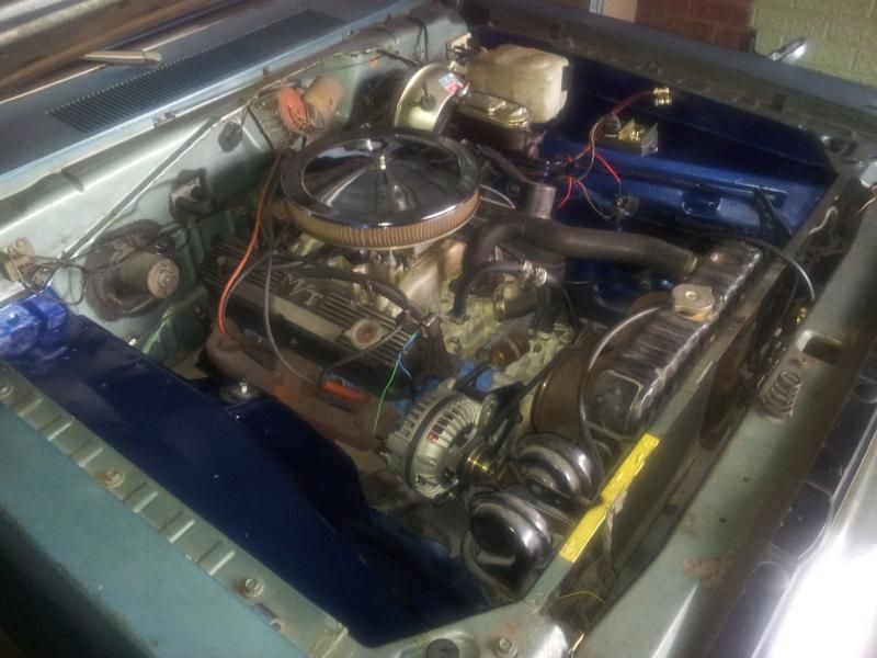

Changed shade and gone Mopar, ripped some parts off, stripped and painted brackets, stripped and moved wires, painted inner fenders and reinstalled.
Removed the heater from the car (never worked anyway), as I didn't want to drill the firewall for the capillary, hooked that lot up last night!

VW Colour test.....
Now
Taken from crappy phone and inside garage....much better in person and in natural light.....
