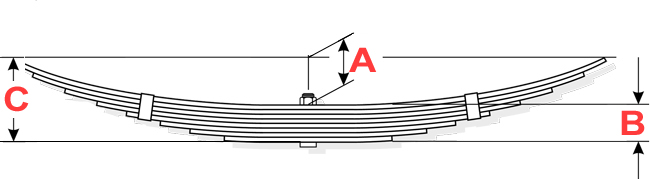

Hoping someone can help....
I'm re-tempering my leaf springs on my '69 Charger...
I have dropped them off with GME springs in Cov, but they need to know the original spec for the "Free Camber" - (That's "C" in my little pic)
I can't find any info anywhere about the Arch (A) or the Pack Thickness (B)... so I'm really hoping someone can advise??
Just looking for a stock look. My springs were shot and sat almost flat with just the weight of the car on them!
Any Help much appreciated !!
leaf springs.jpg (57.37 KiB) Viewed 1218 times

Wish I could help Sean. Just checked my manuals and gives lots of information , but nothing on the dimensions you are after.
Sorry. :(

Thanks Gary - I found that chart this evening too! Great minds....and all that.
I'll pass that on to the guys doing the re-tempering - cheers
