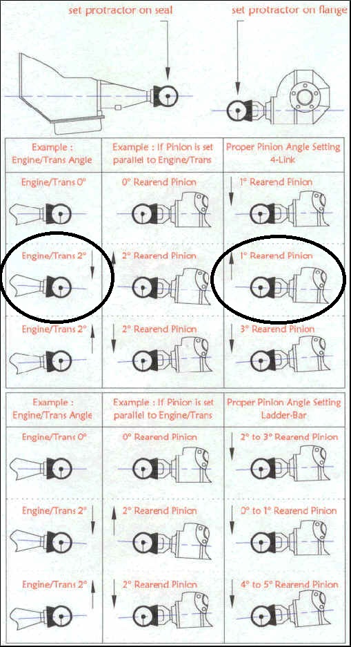

Check the angle of the output shaft of the gearbox to the input shaft of the differential. What you describe sounds like the nose of the diff is potentially pointing too high or low. Same can also happen with very saggy transmission mounts, making the transmission point too low.
I have the adjustable front spring hanger mounts on my car and in the higher position caused a similar vibration as you have described. I swapped it back to the lower position and the vibration went (note: the adjustable hanger mounts should be used with angled shim plates under the spring perches).

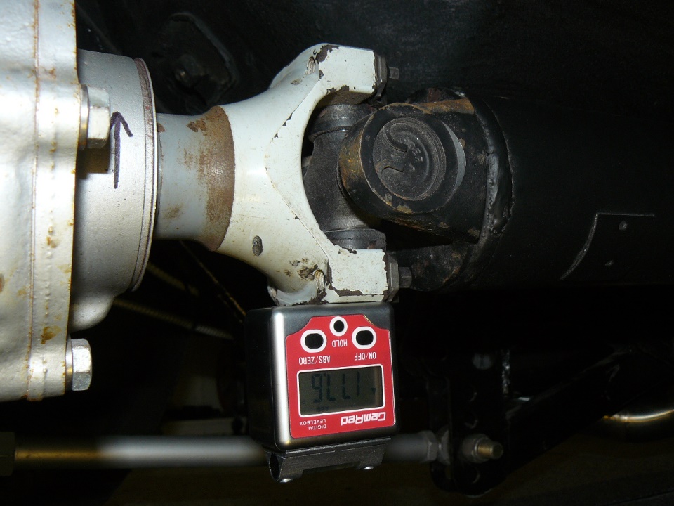

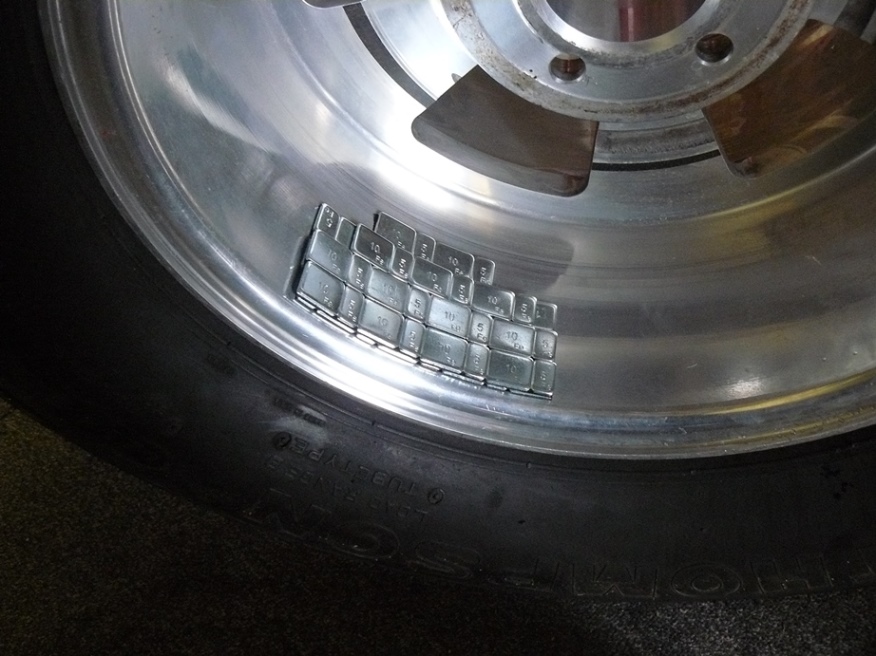

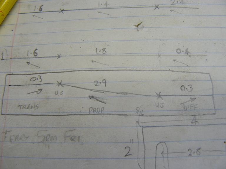

Philth wrote:Check the angle of the output shaft of the gearbox to the input shaft of the differential. What you describe sounds like the nose of the diff is potentially pointing too high or low. Same can also happen with very saggy transmission mounts, making the transmission point too low.
Some descriptions here: -
http://www.hotrodhotline.com/md/html/dr ... monics.php
Loads of other info out there....(yup - I looked it up too when I was flummoxed!).
If your vibration goes away in neutral, that's likely your problem.
If it stays you're looking at an imbalance in the motor/ flex/ damper/ 'verter.
I had issues with my gearbox/ prop/ diff relative angles. I had to pack my gearbox mount and drill extra holes in the motor plate to sort it.
It didn't help as my problem was actually the rear wheels being massively out of balance, check out the weights in the pic!
I used this guide and invested a well-spent £34 on a digital level :thumbright: :o

UJ's are new Gary, but I'll try the gears.
Thanks for the info Paul I've got a gauge & will take a proper look at the weekend. :thumbright: that's a lot of weights!
