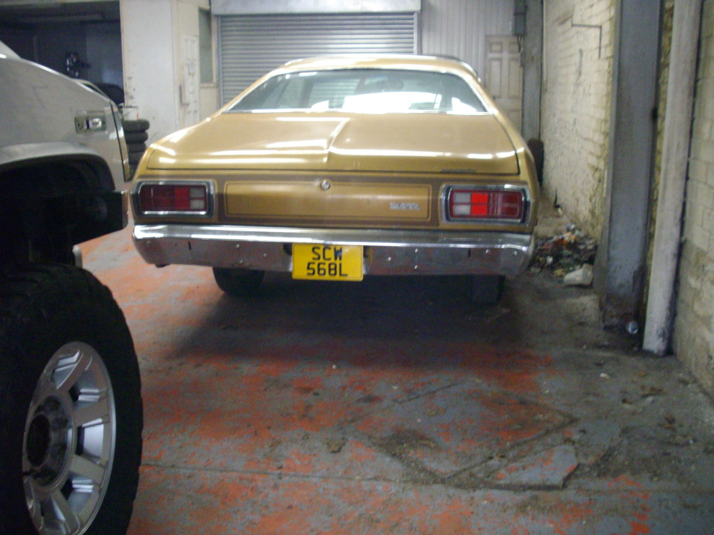

Hi all .. Hoping to get heads up on getting my 318 engine rebuilt . A friend has recommended Cleaseby,s at Durham but they just do the rebuild ,and I,m wanting it installed and set up for me . You might guess I,m not the most mechanically gifted person on here . oh by the way my Duster has 225 slant 6 at moment .
