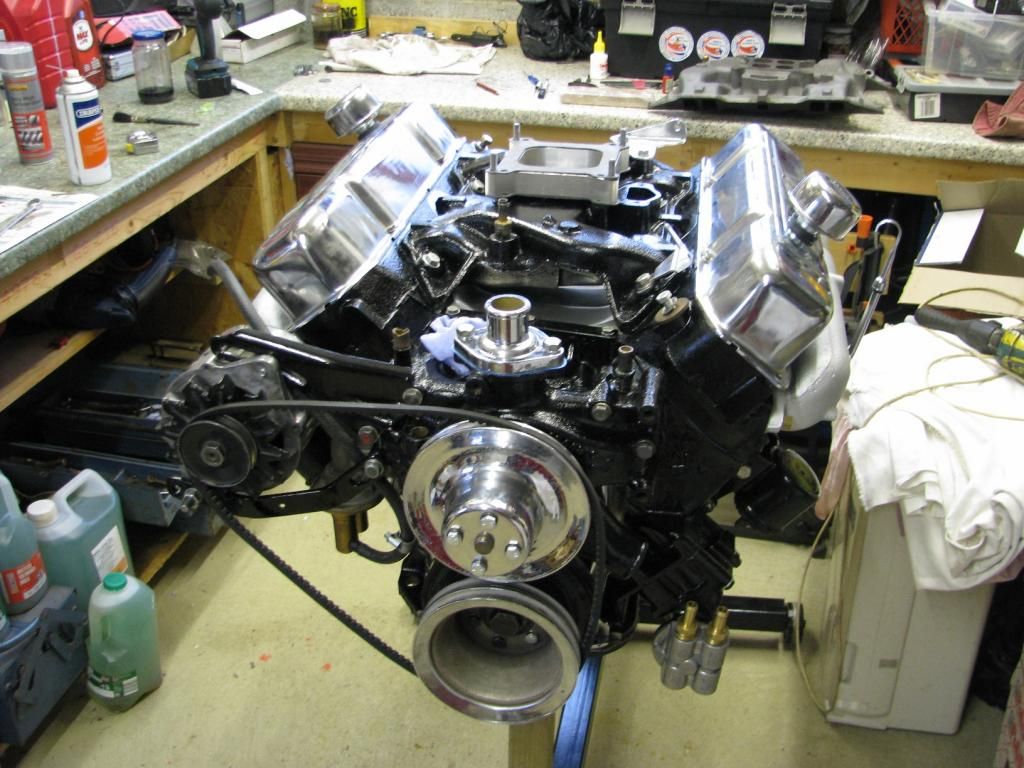

The crankshaft was reground by Welham Motors in Leicester and they checked over the block, pistons/rods and camshaft and confirmed they are OK. Parts were given to me by Terry and Steve on here and Dave B, Real Steel & C M Frost supplied other parts. I fitted new crank bearings (of course
The engine set did not have any side seals for the crank rear seal retaining block. Instead you have to fill the grooves with RTV silicone and then push in a (supplied) dampened pipe cleaner, which is supposed to make the RTV go off. I did not rate this system at all highly. After the first fit, there were gaps left down the side of the retainer. It's v. difficult to not smear off the RTV as you push the retainer down. I re-did it making sure there was lots of excess RTV and smeared it up the outside of the block. I hope it did the job
Anyway, my question. The engine is arranged with a remote oil filter (see connections in pic above) and when I removed the engine and this from the car, the filter and feed pipes were empty. The filter mounts high on the inner wing. Also, it seemed pretty small, about the size of a Mini filter
I have found some larger filters which will fit and also one with a non-return valve. Is a non-return valve a good idea?
