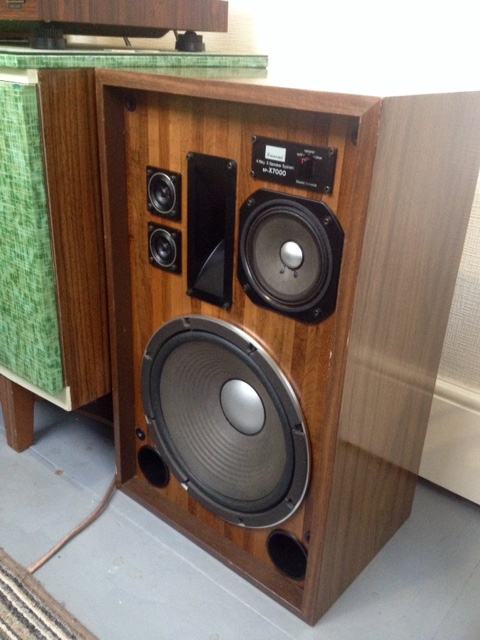

Had my doubts the Wharfedales would work but thought it was worth a punt for nine quid. Work perfectly

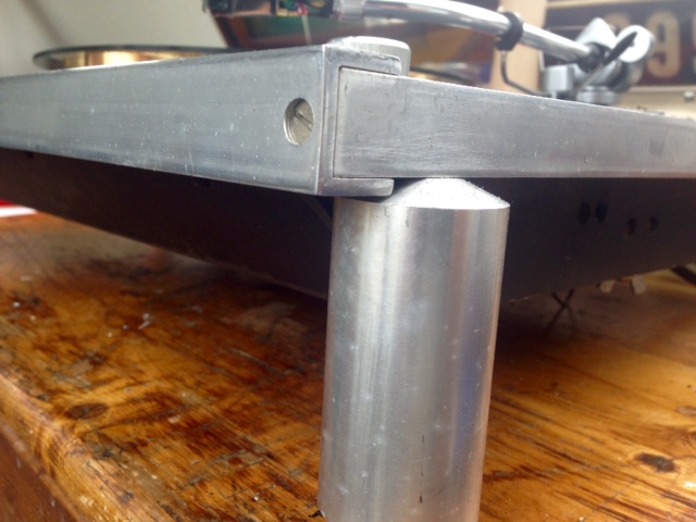

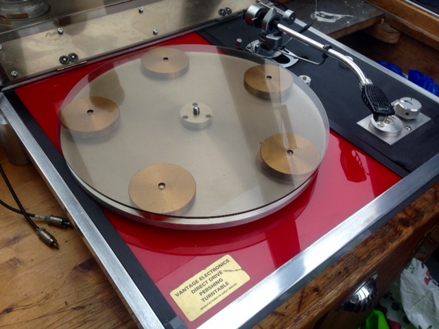

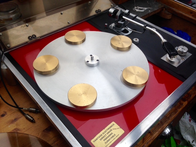

Managed to score this cracking bit of kit. It's a one-off and must have cost the guy who commissioned it an absolute fortune. The platter and legs have been machined from solid billet - same for the brass pads. The whole plinth frame is also aluminium. Plinth is glass. Platter top is Acrylic. Arm board is wood. Arm is an SME 3009 which go for £350 second hand. I paid less than that for the whole thing including a new Ortofon cartridge. Sound is sublime! Going to strip the whole thing down and give it a damn good polishing. Plinth will be replaced with polished rosewood veneer.
