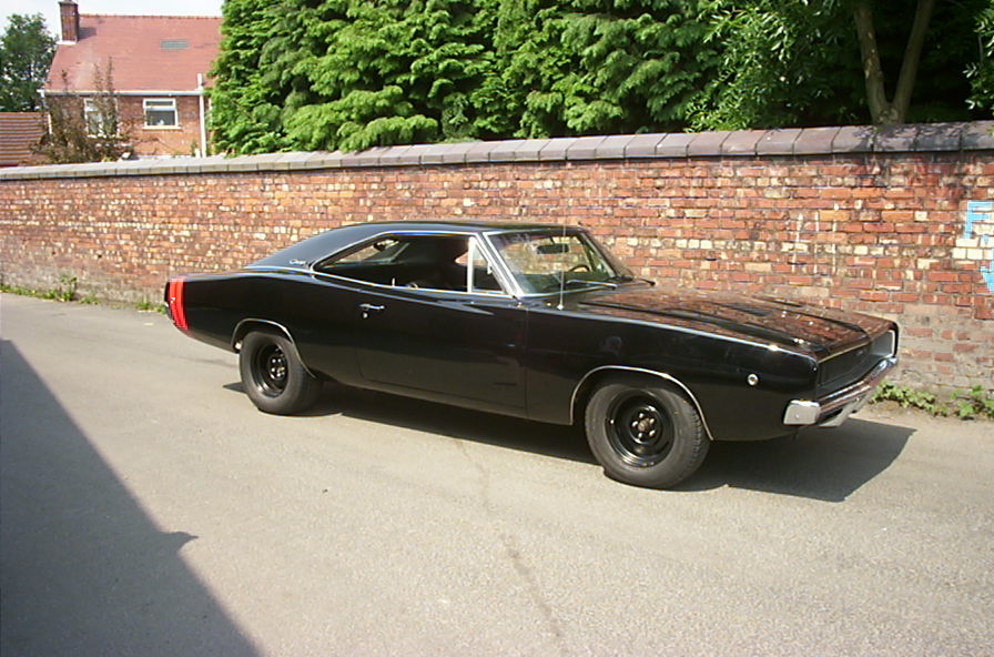

Posts: 22163
One I did earlier:
Proper car.JPG (135.16 KiB) Viewed 2526 times

Looks killer. I do like those steels.

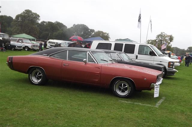

Posts: 7533
I'm the same as Pete for the rears but have got 235 on the front.
DSCF6931 (Small).JPG (44.01 KiB) Viewed 2499 times
Posts: 22163
Your Tiger Paws look a bit under-inflated.
What pressure are you running - this can make a big difference too.
