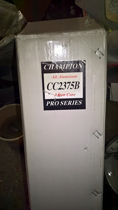

Champion 3 core A-Body rad, listed to cool 650HP job done :thumbright:

Ashley do you have a number for that Rad.
