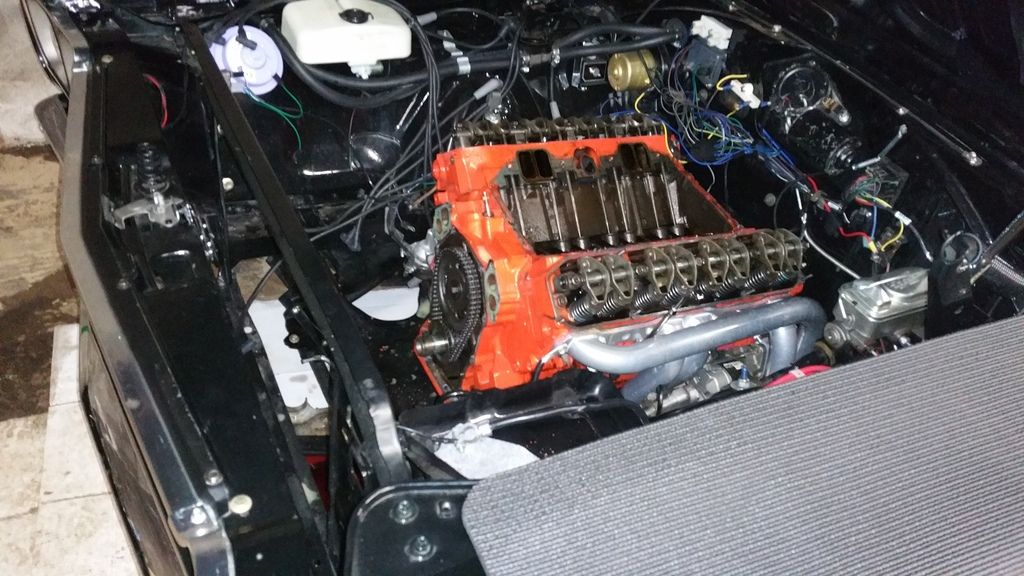

hey folks, thanks again for the positive comments. well i've done the cam and the car is much better,
even on these very cold mornings ,two stabs of the throttle and it fires up straight away and ticks over on its own,
set the six pack and kickdown up as stock, it runs and drives great, have an air leak on the rear carb , but will sort that soon,
now its not a multi feet dance to stop, having to blip the throttle to stop it from stalling while slowing down in neutral .
the brakes could be better, but now i've 17 inches of vacuum at idle instead of 4.5 I can put power brakes on,
that's next weeks project, need a bit of heat in my garage first,,
also have to sort out the colour of my engine, had the correct shade mixed for the valley gasket and new rocker boxes, but completely the wrong colour for the rest of the engine, oh well something else to deal with,

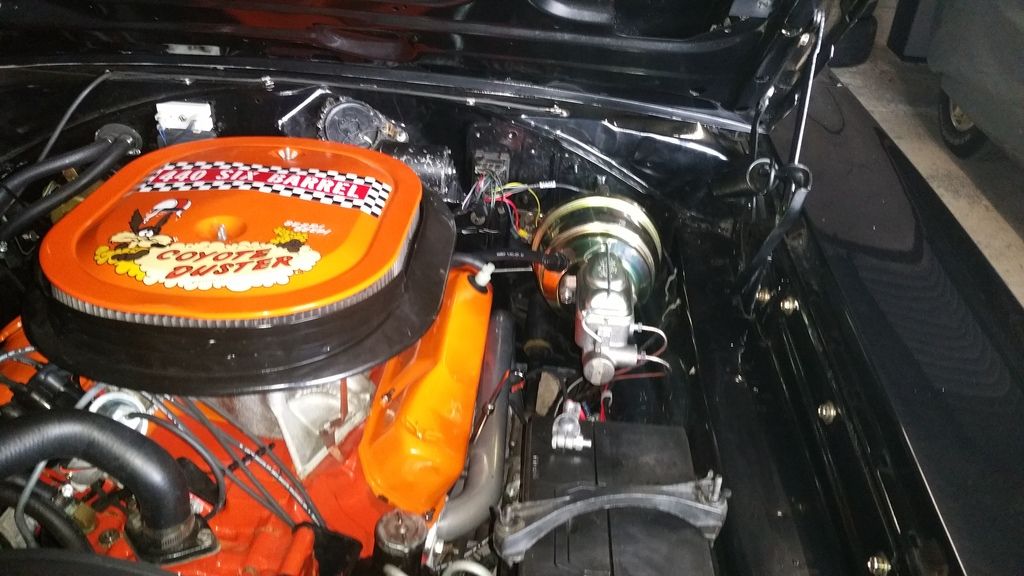

hi folks,
finally got round to fitting the new servo, master cylinder and bias valve, my car at some stage it had been fitted with discs on the front but still had the original drum / drum bias valve, but had been updated with a disc / drum manual master cylinder.
the brakes were never great , in fact my old roadrunner with drums all round stopped better ... LOL
anyway I did my research and found the bias valve of a '78 Cordoba had all the correct fittings to suit my car that had a drum / drum bias valve, it fitted with little problem, other than the headers being a pain in the arse to work round,
the master cylinder / servo combo fitted very well with new firewall gaskets etc, had the correct rod and fittings and was adjusted perfectly to drop straight in, just had to make the lines from bias valve to master cylinder,
a very straight forward job after bleeding, and checking the adjustment on the rear shoes,
I cant believe how much of a difference it has made, the car now drives more like a modern car, very little effort needed to stop, and has made it more of a joy to drive,
