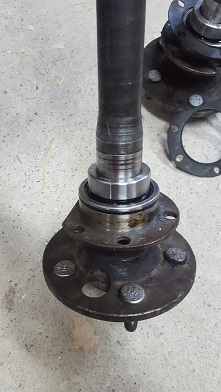

Picture of what is currently fitted
Post by toppers33 »
If someone could please confirm these are the green style bearings I'd appreciate it.
Regards.

Yes they are green bearings in the picture.

Hausers stock green bearings..........
https://www.hauserracing.com/collection ... ange-a1022
CM Frost are a good place to call for taper bearings..........
http://cmfrost.co.uk/National.html

OK, I've ordered and received the rear wheel bearings from Hauser (super fast delivery too), old ones are off and ready to press new ones on tomorrow.
I can't believe what little parts hold the rear drive shafts in! There's only the retaining plate pushing against the snap ring to stop the bearing thrusting out and then there's only the interference fit of the bearing to shaft to stop the shafts thrusting out. It obviously works but there seems not much holding it all in!
My stack up of parts is hub/drive shaft retaining plate, gasket, brake plate, bearing, wedding ring. These green MO400 snap ring style bearings don't have the stepped shoulder like the 1st generathing bearing that I removed does. Just an observation, I'mn sure I'm not the only person to be surprised by how little mechanical clamping there is to keep it all in place!
