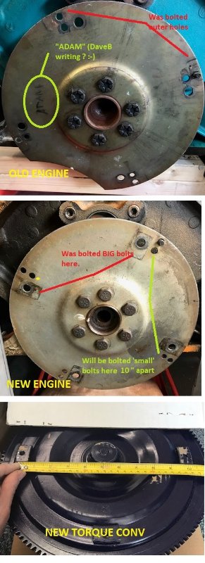

OK chaps - got gearbox out and checked new torque converter fits (phew - it does) but it does look different.
Old one is huge, like 12"+ and the new one is 11". Same splines etc so all good. BUT the old one is externally balanced - which makes sense as it came off my old 318 and went onto my mild 440 - (cast crank engines i assume ?)
My problem is that the new torque conv is NOT externally balanced which the instructions suggest is fine if crank internally balanced (forged?) crank.
Does that make sense ? I dont want it to shake itself to bits ! Easy way to tell from the outside ?
Cast/Forged crank identification ?

Re: Cast/Forged crank identification ?
you can buy a after market flexplate from B&M
2 x 1969 Dodge Darts
A cast crank BB will have a damper double the thickness of a steel one, maybe youve been lucky and your motor didnt need a balanced converter
New engine has flex plate attached.
So plate matches engine - i was trying to ascertain if torque conv needs balancing.
If the flex does the balance then i am ok.
Will re-read. Maybe thats all it means - make sure you are using the right flex plate.
Ta...
Ta...
No your convertor doesn't need balancing. Your new convertor might have large 7/16" bolts rather than the tiny 5/16" stock convertors come with, If it still has small bolts check that your new flex plate hasn't been drilled out for the larger bolts.
Top info chaps. Bolt check when i get home.
Yep; its all good. Both converters have 10" smaller holes fitting the orig bolts.
Interestingly you can see on the flex plates where they have been bolted previously. Old zonking great converter bolted on outside holes.
New engine used to use big holes, but has the small holes in the right place so all good.
