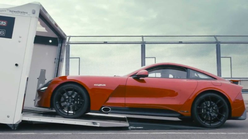

I used to believe the same Dave until i was at the classic car show in 2017.Dave999 wrote: Thu Jul 25, 19 10:29 am yes i think the first exhaust gas "exit" has to be behind the last opening window or some such
They had the new TVR Griffith and the exhaust exits just behind the front wheel.
Not sure what the law is:

Quote from MOT inspection manual. Section 6.1.2 Exhaust system
You must check the exhaust system of all vehicles with an internal combustion engine, including hybrid vehicles.
You need to assess the overall security of the exhaust system. One or more missing or defective exhaust mountings does not necessarily make the exhaust insecure.
For exhaust noise assessment, see Section 8.1.1.
For assessment of catalytic converters and diesel particulate filters, see Section 8.2.
Defect
Exhaust system has a major leak or is insecure. Major
Exhaust fumes entering cabin. Major
Causing a danger to health of persons on board. Dangerous
There is no failure just because the exhaust does not clear the body of the vehicle. Exhaust fumes must enter the passenger cabin to fail.
Back to Jems failure the failure would be a major leak not just blowing. On vehicles that get the 4 gas emissions test (generally post 01/08/1992) if the exhaust leak is bad enough to fail usually the lambda reading would be outside limits .
Maybe the tester was a bit keen.
