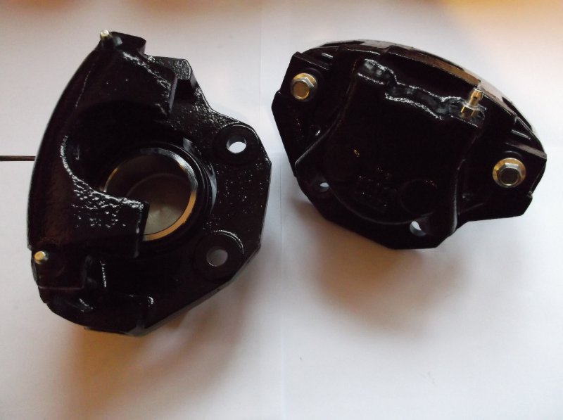

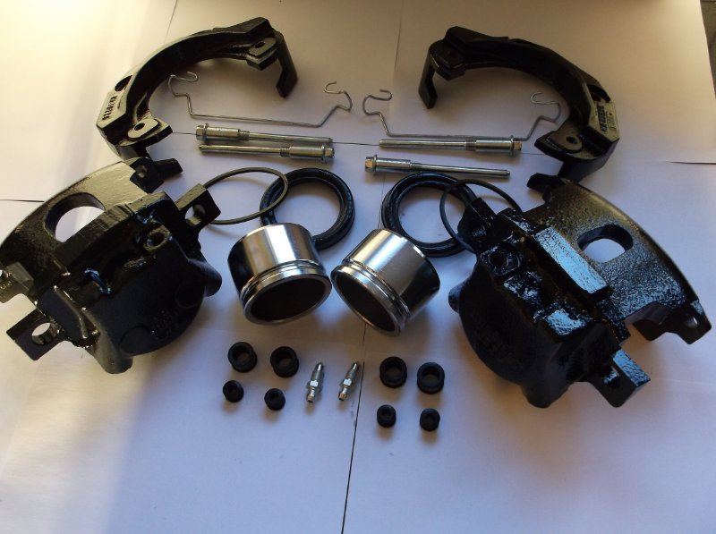

Well here we are, a full rebuild kit from Rick's Mopars ( Rick Ehrenberg who's the Technical editor for Mopar Action magazine) and we're in business.
Better than Princess 4 pots? Hell Yeah ! Thanks for the advice guys.

No matter how crusty they look those later single piston calipers can almost always be rebuilt as the seal doesn't move so bore condition is not important. The earlier 4 piston Kelsey Hayes calipers are different story as the seal slides with the piston so if the bore is scored or pitted which they often are you're looking at replacement or a very expensive repair.
Re: Front Calipers
those 4 pin sliders work well especially if the pins and bushes are new... the issue used to be getting the pins and bushes....but these days rebuild with new is possible as you have found.
i think they are a kelsey hayes caliper as well.....
the slider caliper with the claw and spring plate is a girling Lockheed design or girlock they come off later cars than yours. Looks like you have standard fitment for your car or at least age appropriate.
they should work perfectly well provided you apply some thought to front/rear bias

Should be no problem Dave as these were the ones fitted to the car.
