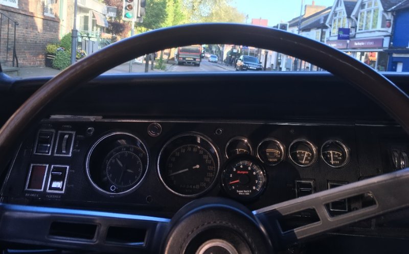

Also the car has been well set up on a traditional dizzy.. Is it fairly easy to wire in a Tic toc tach as it doesn't have one.

Welcome, great choice of car, if you want it to look original you need orange stop and tail bulbs, or get the stanard clear ones ang some yellow / orange bulb paint, the more coats you put on the darker it gets, why not wire in a normal rev counter unless you already have a tic toc tach. photos would be good.

Oh, and wot Del said - unless you already have the ralleye(sp?) dash with tic-toc-tac I'd just go with a third party. In fact I have got the posh dash and gave up with the tic-toc-tac. Nice and easy - 12V and coil feed - done.
