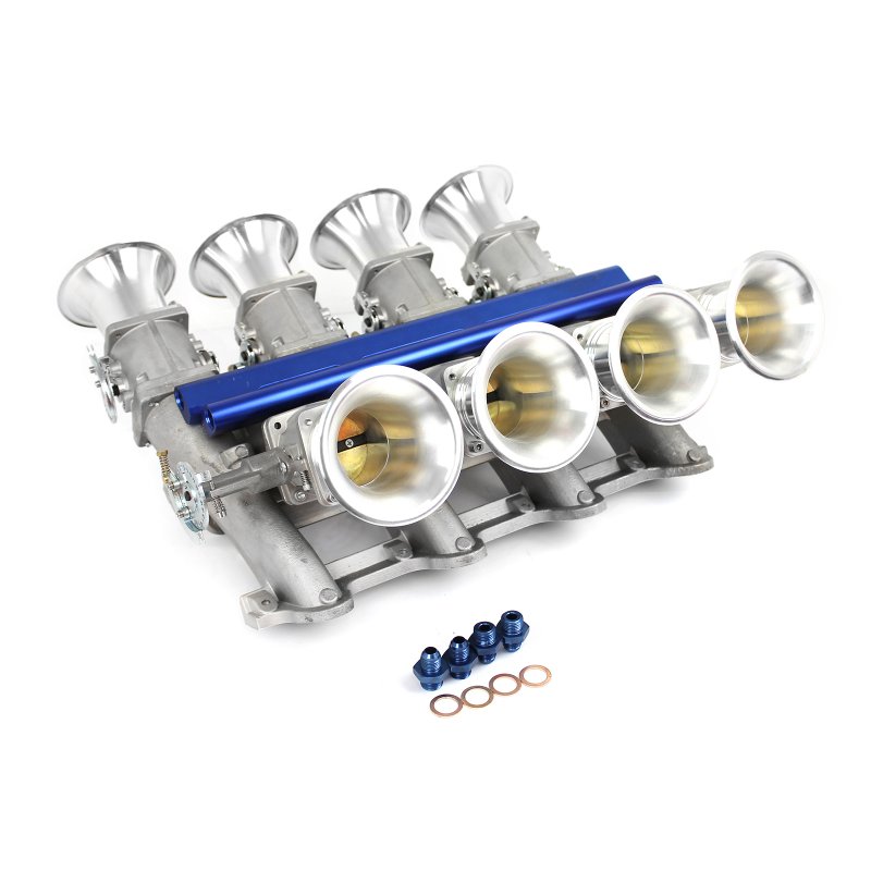

i have fitech on my LS engine, although its a stock LS style system, the hand held unit and software is the same as the four barrel system,
ive found it very easy to use and tune after a little research,
most of the problems ive heard of are from bad instillation, or not following the instructions,
the other problem with all the systems is inlet manifold, i cant remember which way round it is,
but, it wont run correctly with with a single verses a duel plane manifold, or visa a versa,
do your research,
i'm considering converting my 440 to fuel injection as well,
and i want to put this on my LS>>>>
