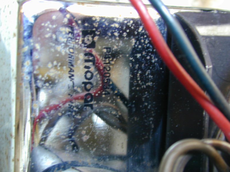

A few pics of the box:
Box & ballast.JPG (99.68 KiB) Viewed 1628 times
C box.JPG (84.6 KiB) Viewed 1628 times
as far as I can read the part number is P4120534.
As most of the coils are oil filled and as Pete says, they are better off mounted vertically, one of the reasons I want to replace....
Sadly no markings on the coil.
As far as I know, the engine is stock late low compression other than a 'hemi grind' cam, headers, carb & intake.
What do you think ?
Posts: 9578
Re: Coil advice
Ok looks like a mopar chrome box to me
P4120534
supposedly race only but i guess you have proved that to be twaddle :D in fact i might be getting confused with the gold one
if it is Vintage its probably good i.e made in the USofA rather than PRChineeeya
id suggest you can run standard coil and ballast i.e chase down something for a jensen....
or run a MSD blaster II. its a very low (0.7 ohm) resistance coil so i'd be inclined to keep the ballast resistor for street use
the ballast resistor is. usually 1.2-1.4 ohms resistance
so if you put in a 0.7 ohm coil that's a total of 1.9 ohms (0.7 coil+1.2 ballast) lets call it 2 ohms
and we can work out the current that will flow once its switched on.
approx 8 Volts/2 Ohms = 4 amps max flowing in the coil primary, that seems alright to me
if you bypass the ballast you get the full 12 volts to the coil
12 volts/2ohms = 6 amps probably too much, will knacker the box or burn out the coil
basically you have a robust ignition box that should be run with the ballast you have
MSD blaster 2 is an option it has a primary of is 0.7 ohms therefore keep the ballast

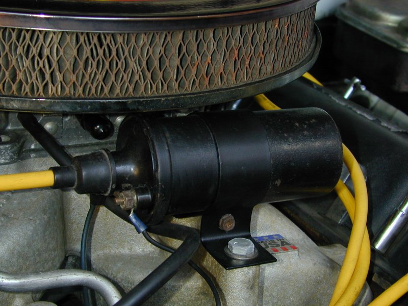

Re: Coil advice
Hi. Sorry for the thread revival but when I searched this seemed to be the most relevant information.
I had my Road Runner tested on a rolling road yesterday to help with carb set up,more in this a bit later. What reared its head was a misfire I thought was sorted and additionally an overheated coil.
The car was set up for me previously and the ballast resistor was bypassed the reason I was told was that not enough voltage was reaching the spark plugs. I ran the car like this for a while and it certainly felt much better at higher revs. During this period I had a coil fail (Super Stack 8140) and replaced it with an MSD Blaster 2 82023. This coil appears to need a separate ballast resistor and when running with it lacks the power it has when not. It runs a Mopar performance module and electronic ignition.
My coil is mounted in the V longitudinally and I realise this is not correct,yesterday it was suggested mounting it upside down much further forward in the engine bay,I’m with the orientation but the position?
I have NGK BP5S plugs which are new and I replaced what originally the car came with,the tech yesterday suggested that my misfire could be down to these running too hot and detonating,he suggested BP6 or 7 to eliminate this,the misfire was evident at 4800 rpm + but at times did not affect the smoothness of the curve recorded on the machine.
Sorry for so many questions, I must admit to feeling a bit deflated and lost for a direction.
Posts: 3625
Re: Coil advice
I'm not sure mounting the coil upside down is a good idea, I used to have a dune buggy years ago with a Bosch blue coil fitted this way, the previous owner thought it would keep the connections dry. This failed and this is where I was first told that some coils were oil filled and mounting them off vertical was a bad idea...
