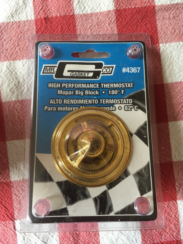

Probably a stupid question, but is there any difference big block / small block thermostats?
Just sorting out a for sale / take to the tip pile and found this in my stash that I didn’t even know I had
- 2269CD94-F8AB-4382-AA9D-A53FEBA660B6.jpeg (141.99 KiB) Viewed 4332 times

Re: Hoses
Balls. Just paid for one the other day that I waiting to be delivered.
Oh well, at least I have what I need. Thanks Blue.
No idea where the hell I picked that up and why, but will have a spare now.
