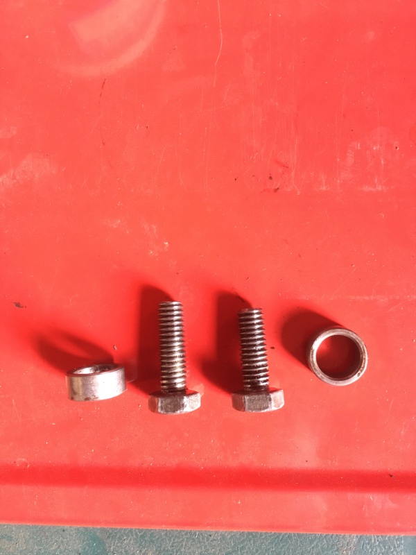

Blue wrote: Sun Jul 25, 21 12:20 pm I just have a generic in/lb torque wrench, anything that goes from 50 to 150 inch/lb is sufficient. Unless the filter looks really bad leave it for now.
May have had an absolute supertwat moment. Just mopped up and pulled those two bolts and realised they are different lengths. Crossing everything that the longer one will be what I need in the back ‘ole (so to speak!)
Should there be anything else other that the spacers between the bracket and the pan?

Nope. That didn’t work. All torqued up except the same offending bugger, so back to waiting for a longer bolt and nut.
Wondering if a simple spring washer may end my woes. :-k :-k

Those spacers look a bit thick, they only need to space the bracket off the lip of the steel pan, a couple of flat washers on each bolt would probably suffice. You don't need them at all with a cast pan.

Blue wrote: Sun Jul 25, 21 4:00 pm Those spacers look a bit thick, they only need to space the bracket off the lip of the steel pan, a couple of flat washers on each bolt would probably suffice. You don't need them at all with a cast pan.
That might just give me the little extra that I need. They are what came with the shifter kit, so that’s what I used.
Maybe, just maybe I will get some luck for once then. I’ll dig through the washer draw. [-o<
