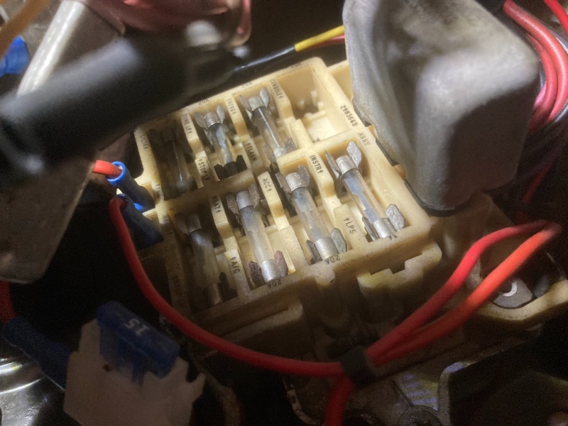

Assuming top right is the instrument cluster, fuse is intact.

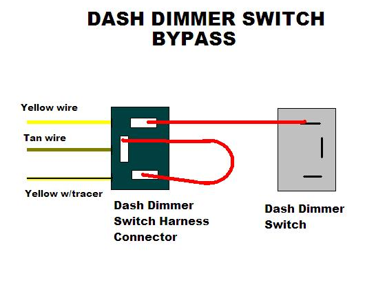

if you want to just not have a dimmer
try below. just link two sections on the connector that hopefully you find lying in the bottom of the dash
dash lights will be full on. when lights are on from now on....
and miss off connection to dimmer switch.
can't think it does anything other than activate dome when wound to 1 end...
instead of taking it to you none exsitant dimmer take it to a standard 2 conector switch with the other switch connector connected to earth i.e its mounting

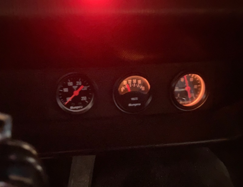

After a real Bananarama! of a week, I needed a bit of success, so pleased to say that after another morning of lying upside down on my neck, we have success. A gentle glow from the gauges and voltmeter now working.
