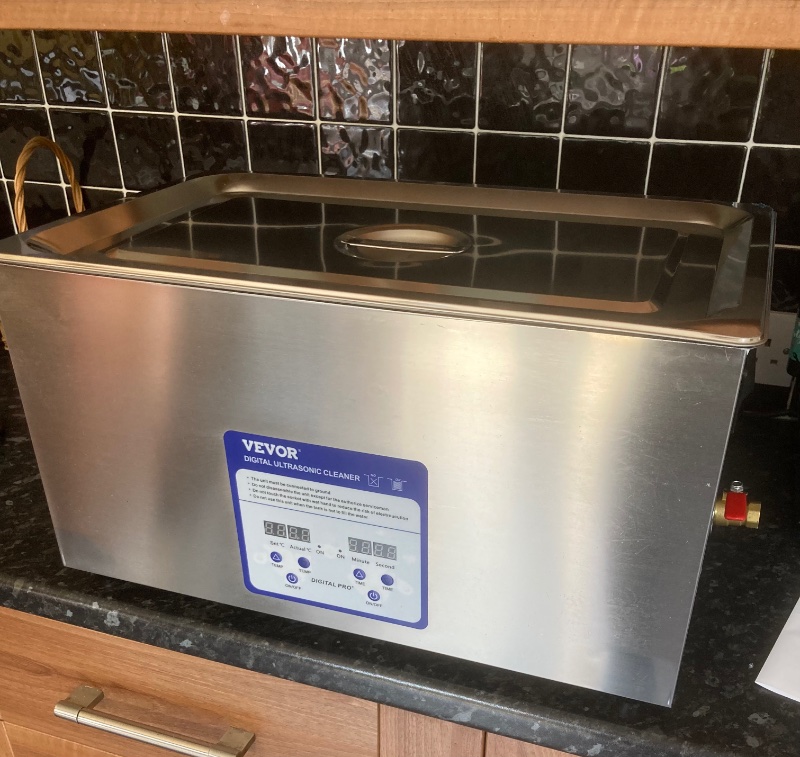

In the meantime, this just turned up! \:D/
Didn’t realise I’d ordered the digital one by mistake. #-o
No idea what I’m doing now, but will be playing with bits of old carb as soon as I figure out how it works. :D
Posts: 9590
looks the same but different to mine
every batch Vevor gets is slightly different :)
its cheap and competant chinese stuff...
as long as you don't read the instructions which will be in chinglish you'll be fine.

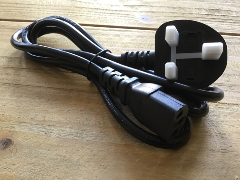

suggest you swap to a UK kettle/computer lead with a UK plug.
its a metal thing with water and eletcricity in it
the lead and adapter that is sometimes supplied has no earth pin connected... :)
its illegal to sell them like that so you are within your rights to have a go at VEVOR if they didn't send the right lead

PS the right hand side is a timer for the cleaning routine
the left hand side is the heater
the display above heater settings works if heater is on or off which is useful for keeping an eye on temp increases caused by untrasound
most relevenat when doing LP records (no more than 35* otherwise they go all bendy)
not that relevant with a hunk of aluminium

Thankfully, it arrived with the correct plug, so all good. :thumbright:
