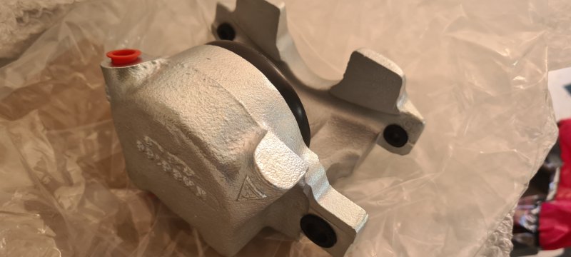

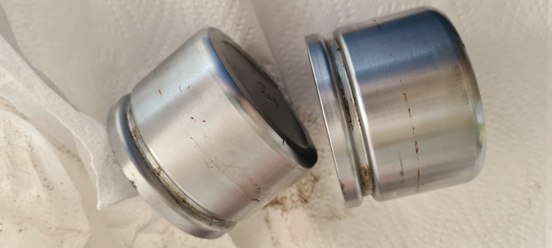

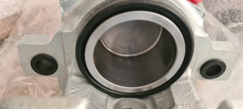

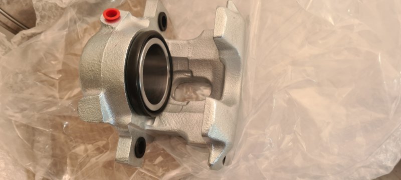

Hi all, I've now completed most of the ideas and plans from previous posts and I thought it was worth updating you, as I'm still not at the bottom of it yet.
Despite the tests (See earlier postings) indicating the problem was probably above the calipers, as I previously mentioned I decided to get the calipers reconditioned just becausse they were both out and I wanted to rule them out. I started out trying to get the recon calipers from the US as recommended - they are cheap as you say, but I couldn't get any pair from the same manufacturer (checked the big 3 or 4 outlets like Rock Auto, Summit, YearOne, etc), They seem to have supply issues, not sure why. Instead, I sent them to BiggRed in Worcester, who have a good reputation for reconditioning calipers and other brake stuff (they do all the brake work for CarSOS). I got new pistons and seals from the US, and BiggRed did the recon work (including electroplating), and refitting of the seals, and testing etc, and they look great (see photos attached). Worth mentioning that the old pistons that were removed did not look at all bad, just a few light marks from the seal - see photos attached.
I also bought new slider pins and flexible hoses, and then put the calipers back on.
Before I got around to testing the brakes, I compared the old flexible hoses to the new ones by doing a blow-through. The new ones are certainly easier than the old ones to blow through, so I'm certain the old ones were partly failing and were having at least some effect on the brake binding.
However, having refitted and bled the brakes, the binding is back, at least partly. It's not quite as bad as the start where I couldn't move the wheel at all, but it is dragging pretty heavily, and I can only just turn the wheels around by hand. Again, both sides seem to be affected to a similar extent.
I then removed one of the calipers again and used my G-clamp to try to push the piston back into the caliper, but it really doesn't way to go in even with some pretty heavy twisting on the clamp. I guess this is really just confirming what the initial testing told me - that the problem is somewhere above the calipers. This is also consistent with the old pistons that were in reasonable condition when removed.
Next job was to check the pushrod that comes out of the brake booster and into the master cyinder, to check it wasn't permanently engaging the brakes. The various techniques for measuring this are all a bit difficult but I eventually found a way (on another forum post) that works well: I pulled the brake booster push rod about a centimetre out from its position in 'home position' in the booster (it's loose) and then carefully pushed the master cylinder back onto the studs until it was back flush to the booster flange, ie. its start point. There was no resistance at all from the pushrod as I did this, indicating that it's not engaging the master cylinder piston before the pedal is applied, so that's good. I then carefully re-removed the master cylinder, and the checked how far in the booster pushrod had gone back in, and if there was any more travel before it reached its end position - there wasn't - so it feels like it's perfectly adjusted. Hopefuly I've explained that reasonably clearly! Let me know if any of this sounds wrong please.
By the way, I also checked the pedal mechanism in the footwell - seems to have a couple of milimetres of travel before it engages, so looks and feels perfect to my eyes.
So now I'm at a loss as to what to do next. I'm confident the calipers are all good, and the flexible hoses too. It feels to me like the system gets too much pressure in it and doesn't lose that pressure when the brake pedal is realeased. Any ideas how that might happen? Or what I might check (or change) next ?

- Old pistons (removed)
- 2022-08-20 10.03.30.jpg (123.24 KiB) Viewed 146744 times
- Reconditioned caliper
- 2022-08-20 09.59.34.jpg (95.83 KiB) Viewed 146744 times
- 2022-08-20 09.59.20.jpg (129.25 KiB) Viewed 146744 times
- 2022-08-20 09.59.13.jpg (131.06 KiB) Viewed 146744 times
