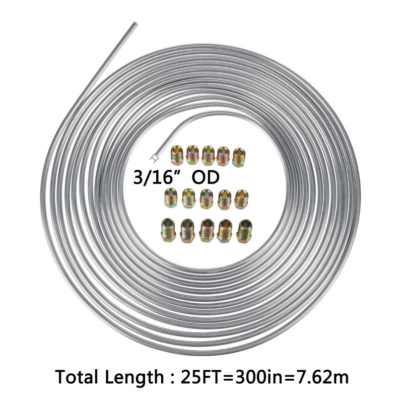

The other option I have seen is this on the bay, "Silver Steel Nickel Kunifer Brake Line Pipe"
Q With this pipe has anyone used it? and does it keep its shiny appearance?
https://www.ebay.co.uk/itm/364070957019 eBay item number:364070957019

Stainless is really tough to work with, you’d need something pretty heavy duty to bend and flair it. If the kinifer is nickel plated I’d say it won’t stay shiny for long once the elements have got to it.

The Cupro Nickel (Kunifer) pipe i used under the rear of the car went a bit green after a year or so, presumably due to the copper content (90%).
But cleans off with some wire wool.
The same stuff i used in the engine bay has stayed the same copper-y colour it was when it was fitted 10 years ago.

the standard untreated kunifer, where you can see it give it a buff and spray it in clear coat or brass instrument lacquer if it works on a trumpet or trombone exposed to dribble and beer most of its life, it will work to some extent here

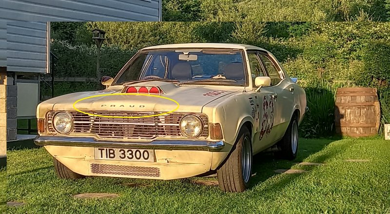

Thanks Dave :thumbright:
MOPAR :-k =
For me its the engine
I do class my car as a MOPAR now ;)

more a case of mopowered :thumbright:
