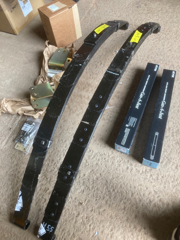

Well, having yanked the rear bumper and valance, this was going to be my today job, right up until I realised they don’t come with the rear bushings installed, only fronts. #-o
Oh well.
The other thing is, having identified which is left and which is right, I can’t see anywhere if that’s looking from the front or the rear of the car. :scratch: :-k :lol:
I’m assuming from the front, but can anyone confirm? :D

They should have part number on them, if not the set with the most leafs goes on the Pass Side...
You did not have to pull the Bumper to do that, but it is far easier (but not impossible) to do the job with the Vallance off...

Pete wrote: Sat Jul 01, 23 3:55 pm They should have part number on them, if not the set with the most leafs goes on the Pass Side...
Yes, I know which is which from the part numbers, but that only correlates to left and right. What I mean is, is that left when you are looking at the car from the front, I assume, not the rear?
Had to pull the number anyway, I forgot to mount the adjustment bolts when I put it on, so it’s all off for now to be redone. Besides, as the bumper is new, I know exactly what would happen if I left it there… :lol:
Posts: 7191
Pete wrote: Sat Jul 01, 23 3:55 pm the set with the most leafs goes on the Pass Side...
Ok, that ties up with left as you look at the car. Cheers Pete. :thumbright:

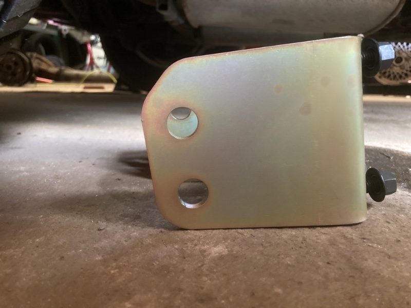

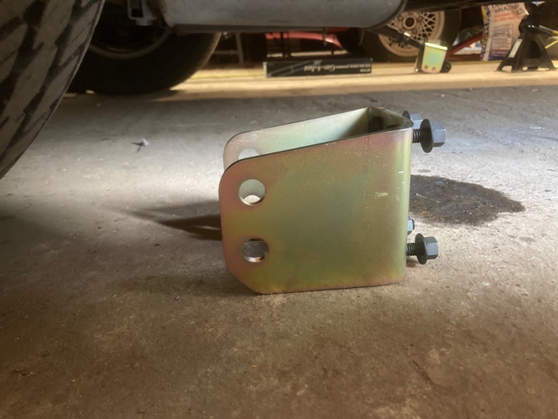

Next dumb question, the front hangers have a rounded edge and an angled edge. Does it make a difference which is top / bottom? :-k
Posts: 14537
I would imagine the angled bit is to clear the floor pan.
Posts: 7191
That’s possible, yes. Will see when I offer them up tomorrow.
Posts: 22176
The Plates are handed and will only go in the Torque Box one way - try a dummy up first before mounting to the spring....
