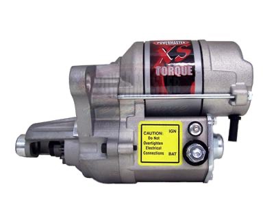

I just bought a hi torques state tee from JEGS for my 383 engines charger. It only has 9 teeth whereas the original has 10 teeth.
JEGS tech guy said it would work fine but I am reluctant to try. Has anyone come across this please?

well most common aftermarket starters for mopars usually have a 32 mm 10 tooth pinion
A Mopar mini starter like this one below, is based on a Mopar OEM part made by denso used initially on 318 360 and v6 Magnum style engines in 80s/ 90s dodge trucks, and for big and small block use usually has a 32 mm 10 tooth pinion
https://www.jegs.com/i/Powermaster/713/9533/10002/-1
did'nt give you one for a chevy 383 did they?
like this
https://www.jegs.com/i/JEGS/555/10001/10002/-1
Basically
is yours a denso? or modelled after a denso like the one in the first picture.
if so they have always have a 32 mm 10 tooth pinion for use with all US mopars of the muscle car era except a few combinations in 1960 and some hemis
If your new starter is a unique or different design not modelled after the OEM Denso part for a dakota truck
Then the pinion size is dictated by the dimensions of that unique starter. so Jegs could be correct and there may indeed be nothing wrong with it
pinion size is dicated by distance from centre line of crank to the mounting, and although the distance doesn't change the offset of the shaft and its mounting in a starter can, when the design of the starter is different.
No. of teeth doesn't matter its the shape that counts
size of pinion dictated by mounting
my own car can use a 25mm 9 tooth or a 27 mm 10 tooth starter the 27 mm 10 tooth has the centre of the starter pinion 1 mm further away from the flywheel ring gear than the 9 tooth one. All dicated by the configuration of the snout of the starter and its mounting holes.. both work fine
not using a denso may be of benefit on a big block. sometimes the dakota truck denso which was never designed to fit a big block hits a boss in the side of a 383 and you have to grind it down.
so if its a denso its got the wrong pinion
if its not a denso and doesn't look at all like the first one mentioned i'd go with what jegs say
all it will do is grind and not start or wizzzz and not start.
but think about if you want to send it back they may well not take it back if its been mounted

Re: Hi Torque Starter
Think I will play save and swop it for the one in th efirst picture!
don't be too hasty
I don't think you need to
it looks like a denso but they may have made it Ultra Torque by altering the gearing inside
if they altered the gearing in the head of the unit the visible pinion shaft may have moved over in relation to the mount
i.e if you change the size of 2 gears hidden in the starter and one get bigger you are going to have to move the shaft it drives
if you move the shaft the pinion on the end will need to chaneg size by the same amount
Hence it has a different number of teeth and a smaller pinion.
I think you are alright
as i say number of teeth doesn't matter its the shape
this starter looks like its based on a denso design but has been modified by the manufacturer
if jegs say it works it will work.
powermaster have a good reputation they will have done a good job.you have a billet alluminium mount on that thing i'd suggest it will probably outlast the car...
this slight design change may also pay divdends in fitment ease as the starter motor body may be rotated slightly away from the block
I think that one’s the Hitachi style, Denso is a bit more compact.

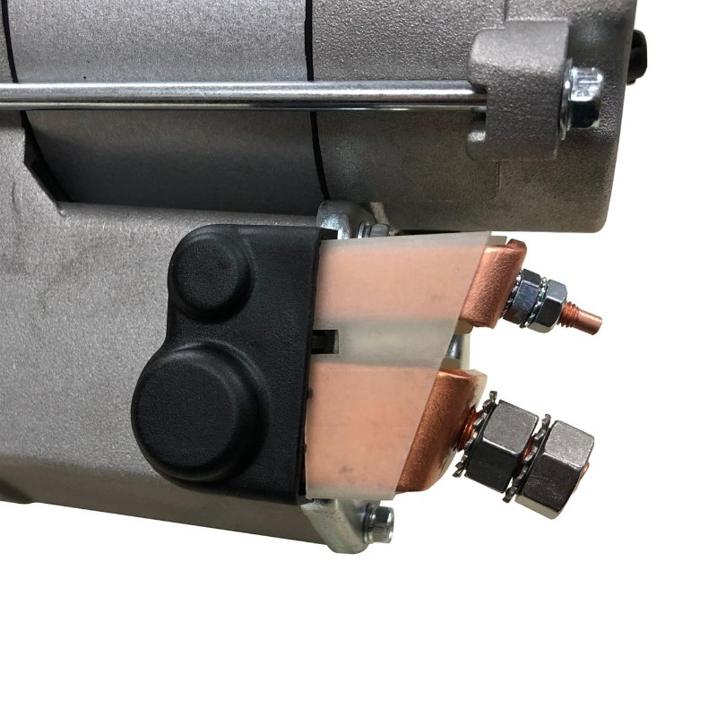

After I fitted the Mini Starter to the Dodge, I found an ad for a useful adaptor to move the terminals away from the engine block. I never did actually buy one so I'm not sure how well it works.
Just found it at Summit...
https://www.summitracing.com/parts/sum-820442 Surely worth a try at $20
(plus shipping obvs)
That adaptor will help with the block clearance issues on big blocks but might then cause clearance issues with cables and headers, not used one either.
