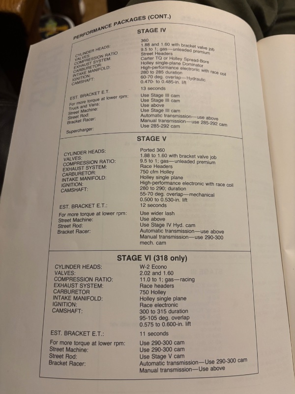

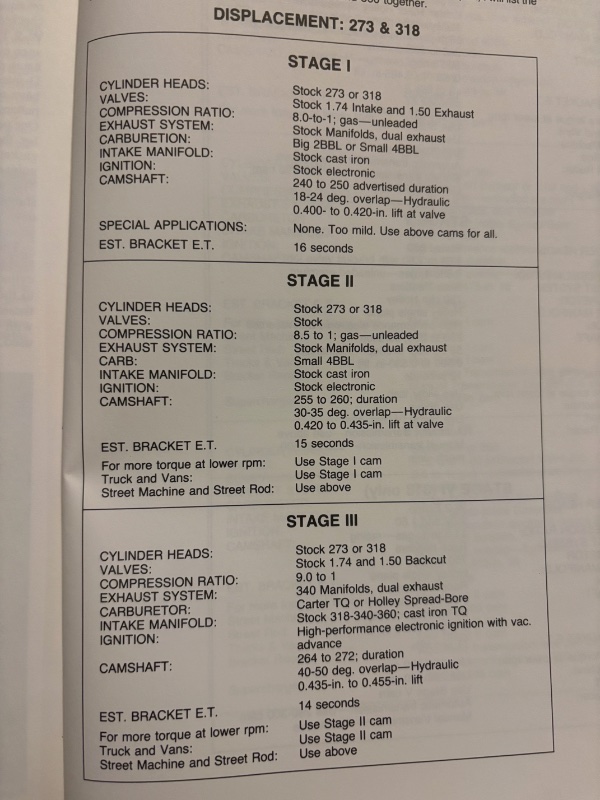

Posts: 7191
Re: 318 upgrade ?
Some pics from a recipe book I have, as food for thought. :D

TIB3300
Posts: 631
Location: Sheffield
Re: 318 upgrade ?
Post by TIB3300 »
Stu wrote: Sun Jan 26, 25 8:57 pm Some pics from a recipe book I have, as food for thought. :D
Thank you Stu Copied now :thumbright:
