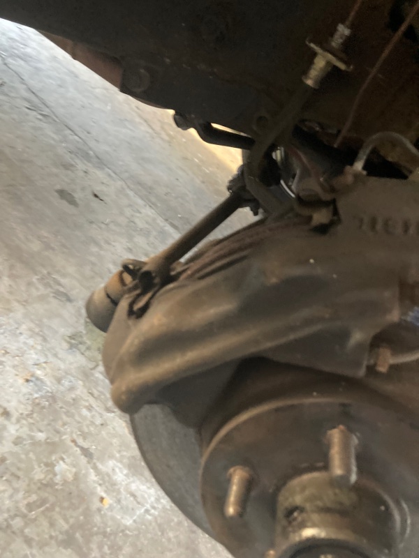

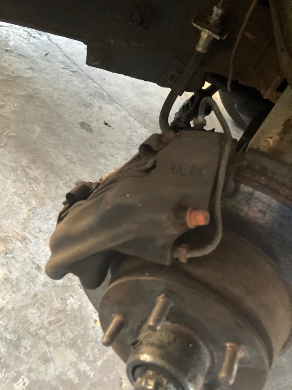

Your car should have Kelsey Hayes 4 pot brakes, as it’s a UK spec model.
I stand to be corrected, so don’t quote me, but I believe early e types used Kelsey Hayes.
Worth checking, as that would put your Jag man squarely in the frame if you can’t find someone Mopar specific locally.

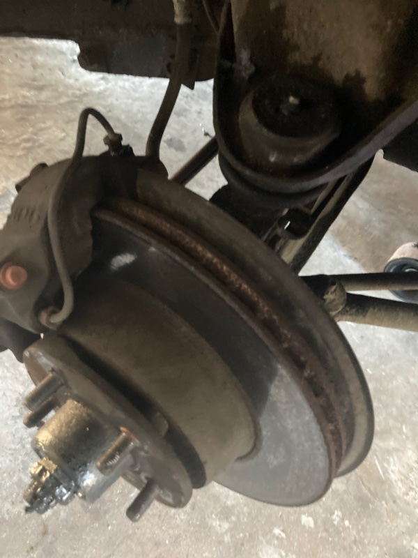

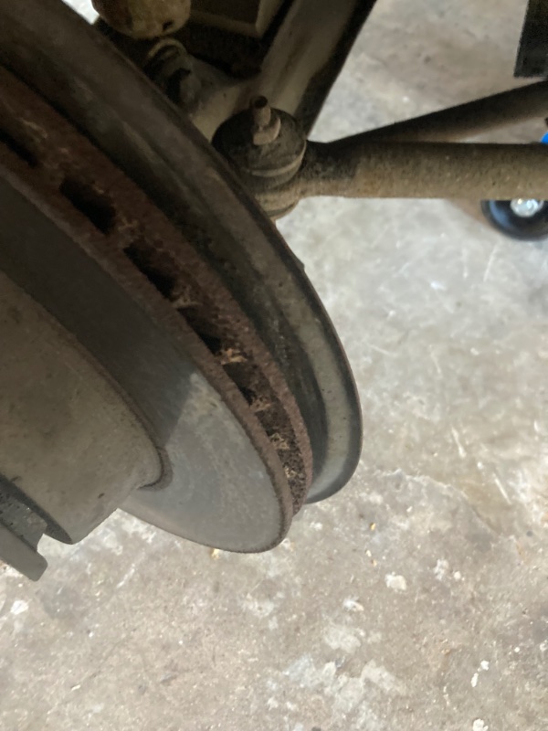

That’s interesting, I hadn’t considered that, is there any way to tell visually, the only identification I could find is a number 71915.

Thanks Dave I posted these pics on the FABO boards and the consensus was that they are KH brakes. I’ve ordered a pair of “Greenstuff” pads from EBC as I’ve heard good things from people who’ve used them in other classics. I’ll check them when they turn up.

Matthew Saxon wrote: Mon Apr 07, 25 9:19 pm That’s interesting, I hadn’t considered that, is there any way to tell visually, the only identification I could find is a number 71915.
I can’t help with the numbers, I’m afraid, but yes those are KH. :thumbright:
